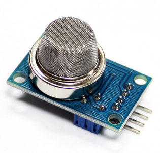

  4. 1x Smoke sensor

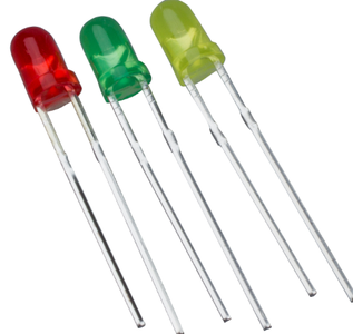

  5. 2x LEDs (Red and Green)

4. Smoke Sensor
  1. VCC → Arduino 5V
  2. GND → Arduino GND
  3. AOUT → Arduino A0
5. LEDs
  1. LED 1 (Green)
  2. Anode (+) → Arduino Pin 3
  3. Cathode (-) → GND
  4. LED 2 (Red)
  5. Anode (+) → Arduino Pin 4
  6. Cathode (-) → GND
