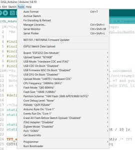

Step 3: Programming the Device (Arduino IDE)
Download the Code
Get the project files from my GitHub repository.
Install Required Libraries
In Arduino IDE, open the Library Manager and install:
  1. TFT_eSPI
Configure TFT_eSPI
  1. Open the file:
  2. Documents/Arduino/libraries/TFT_eSPI/User_Setup_Select.h
  3. Uncomment:
#include <User_Setups/Setup302_Waveshare_ESP32S3_GC9A01.h>
  1. Comment out:
#include <User_Setup.h>
Modify Setup File
  1. add this line to the "Setup302_Waveshare_ESP32S3_GC9A01.h" file.
#define USE_HSPI_PORT // Force HSPI
Connect WiFi
Open the code and set your Wi-Fi name and password on lines 19 and 20.
Set Board Settings
Match the board configuration as shown in the reference image (ESP32-S3, correct flash, PSRAM, etc.).
Connect the Device
Use a USB Type-C cable to connect your Waveshare ESP32-S3 display to the computer.
Compile and Upload
  1. Click Verify to compile the code.
  2. Then click Upload to flash the firmware onto the device.
Once uploaded, your Luna will try to connect to Wi-Fi, and after a successful connection, it will display the Moon.
