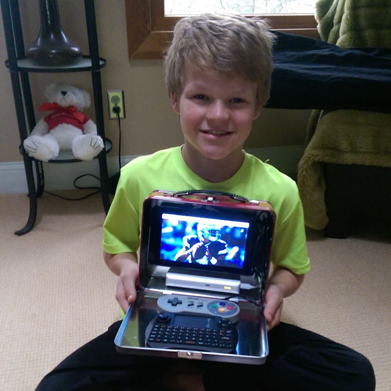

Step 2: Modify the LCD Case
I needed to modify the Touchscreen LCD case because the one micro USB cable that attaches to the monitor board needs to come out of the side of the enclosure so that it can plug into the Raspberry Pi. To do this you will need a drill and drill bits. Start with the smallest drill bit and work your way up to 3/8" bit. This will be big enough so the micro USB cable can be feed through the enclosure.
Step 3: Assembly of the LunchTop
The first step to assembling the LunchTop is to completely assemble the Raspberry Pi, then attach it to the LCD screen and finally secure it with the LCD cover.
Once that is complete your next step is to attach all the parts to the lunchbox and hook up all the cables. I used Velcro strips to secure the battery, Raspberry Pi, game controller and keyboard. This allows me to easily disconnect everything so I can use the Raspberry Pi on other projects (e.g. breadboard and sensor kits).
Step 4: My Raspberry Pi LunchTop
Here is what the completed project looks like. Now go and start building your LunchTop computer and share your results in the comments section.
