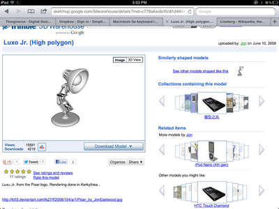

Now, this lamp is the exact lamp as seen from the animation studio's logo and short film. Jon Westwood, who is an amazing 3D designer, created the file on google sketchup and I modified it slightly in order to make it compatible with our 3D printers. Also, interesting fact, my modified design is based off the lamp from the original 1986 short film, not the logo, which has some physical inconsistencies.

First, you'll need the professional version of Google Sketchup. The reason for this is that the pro version is the only way you can export your file as an .OBJ, which will be crucial to it's conversion into a 3D printable .STL file. You can download a several month long trial version from Google's website here, free: http://sketchup.google.com/product/gsup.html
After, either open up your created 3D sketchup model or download it from Google 3D warehouse. Then, go to File -> Export and select .OBJ

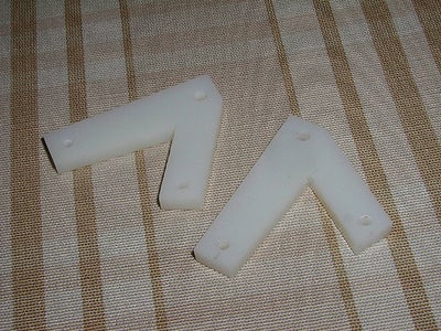

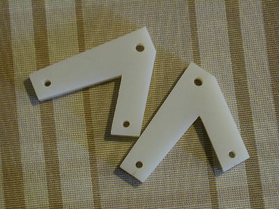

| Neck Joint | 2 |

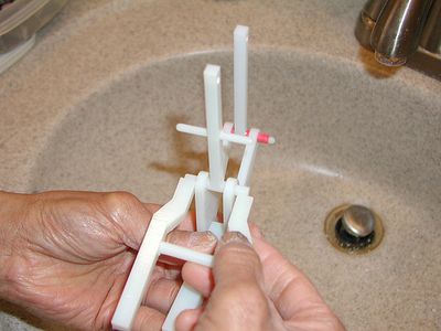

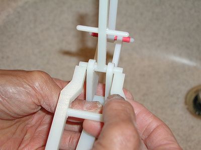

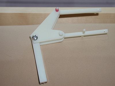

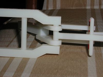

If you ever read my first instructable on my Luxo Jr. Lamp, this part listing and construction should be fairly intuitive. However, I will give the basic rundown on how to construct the pieces.
The Body consists of ten total pieces. Two V-Shaped neck joints, two neck rods, two hip joints, a rectangular leg, an H-Shaped rod with a medial bar, and two waist joints. These attack to Head and the Base of the lamp.

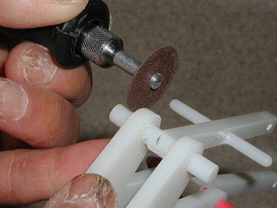

To connect the pieces together, I used 440 and 632 screws for holding them together, and to hold the H-Rod together to the waist joint, I used two small paperclips. I dremeled out the holes on the pieces in order to make them fit together.P

Basically what I did for these two, is use a hacksaw and cut off a section from the rod-like section of both pieces, and then lightly but firmly screw them back in to their respective pieces. This provided enough of a gap in order to screw back in place, while providing the necessary gap in order to swivel.
Also, as a finishing touch, I took some small compression springs I got at OSH (two #104U 2-1/2'' lngth; 5/16'' diameter, and two #84U 1-3/4'' Lngth, 1/4'' Diameter) and attached them to both Neck Rods as well as the H-Rod to Waist Joint, respectively.
