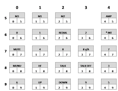

Step 3: The Matrix of the DECT Phone Philips 495
The first picture is a representation of the keyboard matrix. A closed switch establishes a connection from an output of Port A to an input of Port B. By the combination of the output of Port A and the input of Port B can be calculated which button was pressed. The picture with the colourful circles shows the connect areas of each push button. Circles with the same colour are connected. I defined numbers for each colour and assigned them to the areas. You will see the result in the next picture. You can see the buttons and the numbers. For each button the lower number was on the left side. In the last step I sorted the switches according to the left number. Now you can realise the matrix of the buttons. In the next step we solder cables to the areas so that is possible to control the buttons by an arduino. With the arduino we generate connections from port A to port B.
Step 4: Soldering Cables to the Board of the DECT Phone
Because of the matrix for the buttons we don't need two cables for each button. We only need ten cables for controlling all buttons. Five Cables for numbers 0 to 4 of our matrix and five cables for the numbers 5 to 9 of our matrix (as you can see in the picture of the matrix in the previous step). These numbers are not the numbers of the buttons! In the photo of the board with the soldered cables you can see the five cable on the upper part of the board (0 to 4) and the five cable on the middle part of the board 5 to 9). I tried to use the inner point for soldering as often as possible. Be careful that the point and the ring were not connected after soldering.
