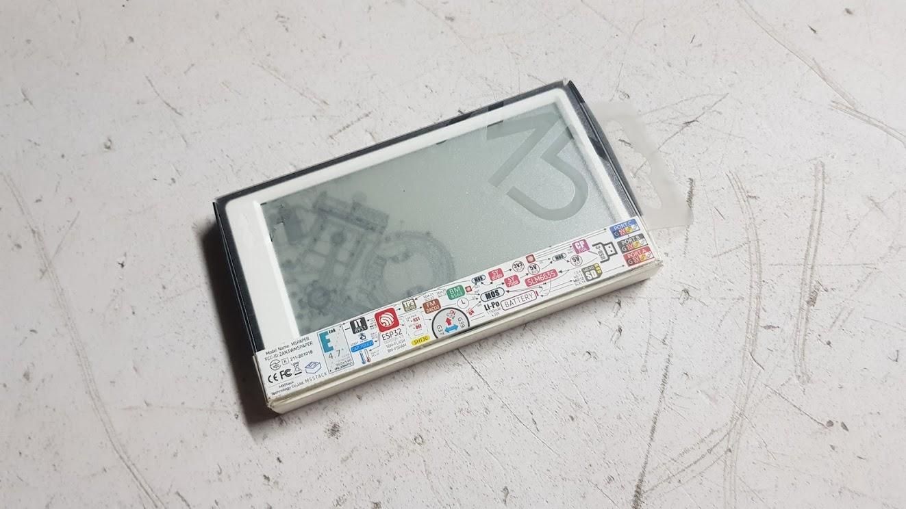

I have one M5Paper which is equipped an ePaper touch screen 540 x 960 pixels, temperature and humidity sensor, real-time clock, microSD, 03 x HY2.0-4P ports. It can connect to WIFI, bluetooth, or implement other protocols like: I2C, UART, DAC/ADC via extension ports and a magnetic attachment system....

M5Paper features:
- ESP32-D0WDQ6-V3 @ 240 MHz dual core, 600 DMIPS, 520 KB SRAM.
- Screen: ePaper / eInk multipoint touchscreen, 4.7 “, 540 x 960 pixels @ 235ppi, 180 degree viewing angle.
- Connectivity: Wi-Fi with 3D antenna, dual mode Bluetooth.
- Memory and storage: 16 MB flash memory, PSRAM 8MB, Micro SD card reader up to 16GB.
- Built-in RTC BM8563.
- Built-in temperature and humidity SHT30.
- Built-in Magnet.
- Internal 1150mAh LiPo battery.
- Expansion connectors x3 HY2.0-4P.
It can be used for the following applications: IoT Terminal, E-Book, Industrial Control Panel, Smart Home Panel....

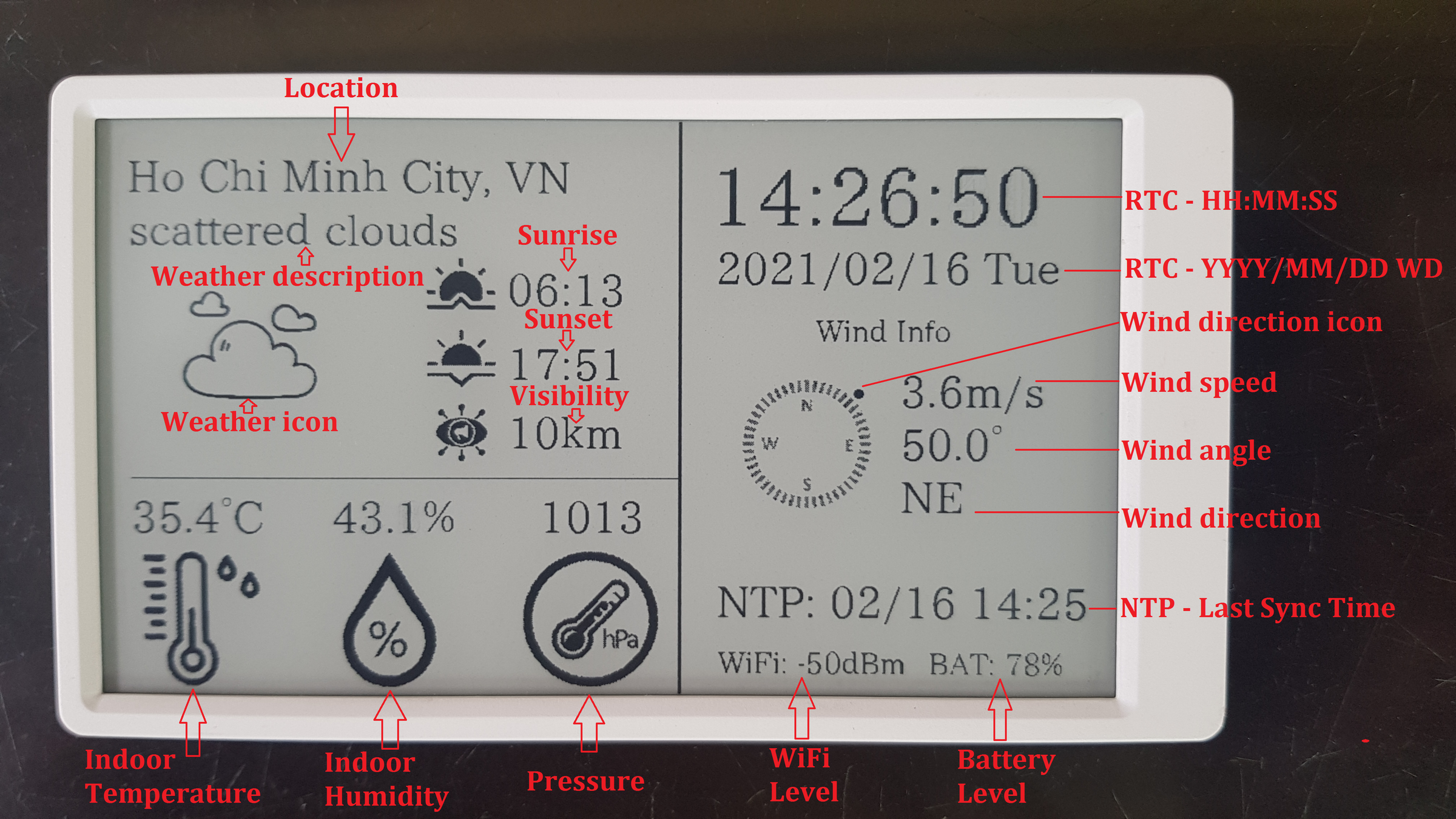

Step 4: Overview Weather Station Idea
To do this weather station, I was inspired by estshorter with his M5Paper dashboard project at:
https://github.com/estshorter/m5paper-dashboard
Since the M5Paper is new product and it doesn't have many resources to refer to, so for me this is a good starting point, both in terms of M5Paper and PlatformIO.
The time & weather information are described in the below picture.
Take notes that:
- The indoor temperature and humidity are read from a built-in SHT30 sensor.
- Time information is read from a RTC built-in sensor BM8563 and it can be synchronized with NTP Time Server.
- The other weather information like: pressure, wind, sunrise & sunset time, visibility, weather icon & description...are read from openweathermap.org

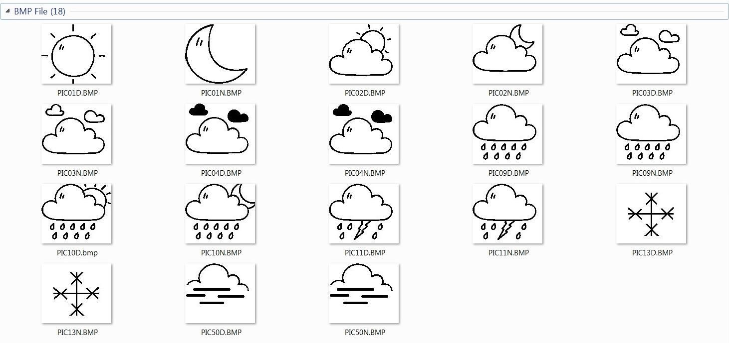

Step 7: Icons Collection
1. Weather icons set by Dooder
https://www.iconfinder.com/iconsets/weather-413
Take note that we should rename the weather icons same like on OpenWeatherMap, detail information at:
https://openweathermap.org/weather-conditions
The "Weather icons set by Dooder" on top link has been named according to their names on OpenWeatherMap.
Because OpenWeatherMap clearly identifies icons between day and night, so that their names have the suffix "D" or "N".

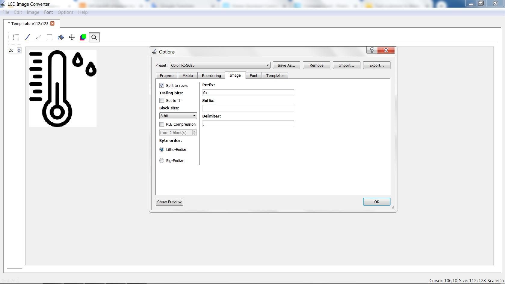

Step 8: LCD Image Converter
To convert all icons collection to "C" code, we can follow the below steps:
- Open LCD Image Converter ‣ File ‣ Open ‣ Choose Image File (or multiple images).
- Go to Options ‣ Preset ‣ Color R5G6B5.
- Go to Image ‣ Block size ‣ 8 bit.
- Go to File ‣ Click Convert (or Convert All for multiple images).
For example in case of a temperature icon with size 112x128:
The setting parameters are shown in header of "C" file after the image is converted.

I have also tried printing all weather icons (night & day) from OpenWeatherMap to a M5Paper screen as shown below:
The URL link of all weather icons are shared on the OpenWeatherMap website, for example URL of "01n" (night icon - clear sky) is:
http://openweathermap.org/img/wn/01n@2x.png
And they can be printed on M5Paper via these codes:
canvas1n.createCanvas(100, 100); // Icon size: 100x100
canvas1n.setTextSize(3);
canvas1n.drawPngUrl("http://openweathermap.org/img/wn/01n@2x.png"); // URL of night icon - clear sky
canvas1n.pushCanvas(50,0,UPDATE_MODE_GC16); // Position to show icon.As you can see, some image details are lost, even 2 icons ( "03d.png" and "03n.png") are not visible because they coincide with white color of M5PAPER screen.
