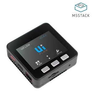

In this tutorial you will learn how to make a simple Weather station using M5Stack Core ESP32 & DHT11 Temperature and Humidity sensor.

- M5Stack Core ESP32 more info here

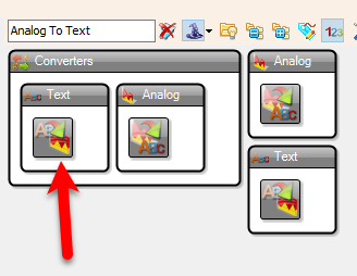

- Add "Analog To Text" component
- Add "DHT11" component

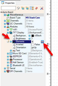

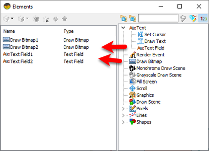

- Select M5 Stack Core and in the editor Modules>TFT Display>Elements, click on [...] button, so that "Elements" window will open.

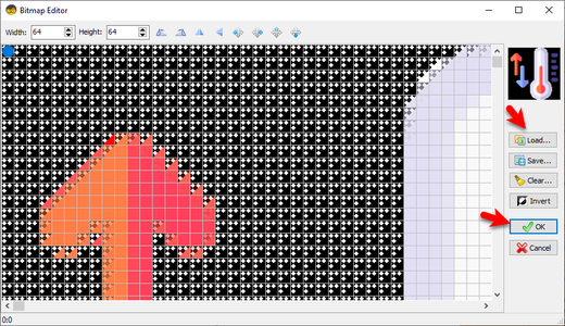

- In the Elements window drag "Draw Bitmap", and in the Properties window set "X" to 20, "Y" to 40 and Select "Bitmap" and click on [...] button, Load the Bitmap for the Temperature, Ideal size is 64X64
- In the Elements window drag another "Draw Bitmap", and in the Properties window set "X to 20, "Y" to 150 and Select Bitmap" and click on [...] button, Load the Bitmap for the Humidity, Ideal size is 64X64

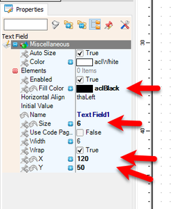

- In the Elements window drag "Text Field" and in the Properties window set "X to 120, "Y" to 50 and "Size" to 6

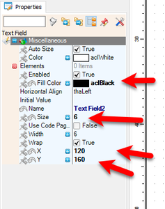

- In the Elements window drag another "Text Field" and in the Properties window set "X to 120, "Y" to 160 and "Size" to 6
- Close the "Elements" window
