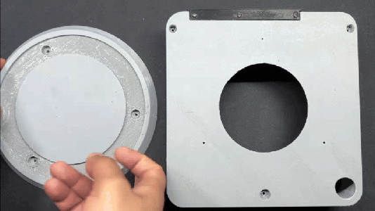

To make the design more like a Mac Mini, we also created a Lifting part that lifts the whole model off the ground; this element is secured to the main body with three M2-sized screws.
On the main body, we have also included a circular opening where we will place the ON/OFF Push Switch, which will be used to restart the Compute Module 5.
Then we have the Top Lid Part, which is put above the main body and covers the main body within it; we designed it so that it acts as a cover for the main body and the rest of the model. The only visible components are the I/O Cover, which is located on the back side of the design.

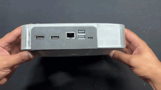

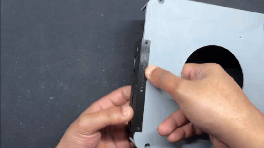

  1. The assembly process begins with placing the I/O Cover on the Main body, which is then secured in place with three M2 screws.
  2. Next, we attach the Lifting part to the bottom side of the Main body by aligning the mounting holes on the Lifting part and the Main body. Next, we use three M2 screws to hold them together.

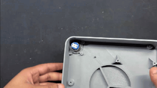

Step 6: POWER SWITCH
The power switch is then inserted in the hole on the main body and tightened in place using the provided nut.

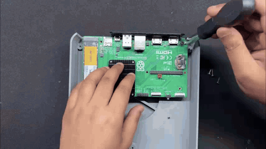

Step 7: BASE BODY - CM5 ASSEMBLY

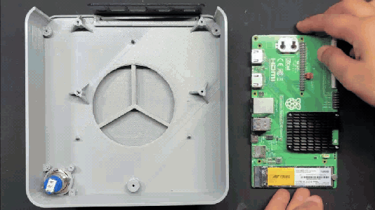

  1. After assembling the main body, we line the Compute Module evaluation board over the Mounting screw bosses and secure it with four M2 screws.

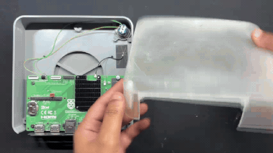

  2. We also soldered two wires in parallel with the Push Switch on the evaluation board and connected them to our newly added ON/OFF switch. This will function as a reset switch for our evaluation board.

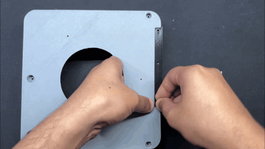

Step 9: FINAL ASSEMBLY

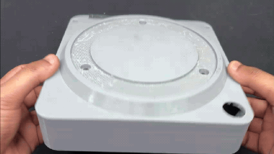

  1. For the final assembly, we installed the Top Lid portion. We had to remove the lower Lifting part for a short time because we modeled the Top Lid part in such a way that it has three screw bosses, one of which is hidden under the Lifter part. To access this screw boss, we had to unscrew the Lifting part and then add three M2 screws to three screw bosses that will mount the Base body and Top Lid part together.
  2. After mounting the lid part to the base body, we can reattach the lifting part and secure it with three M2 screws.
Assembly process has been completed and our device has been finalized.

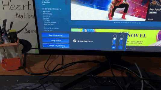

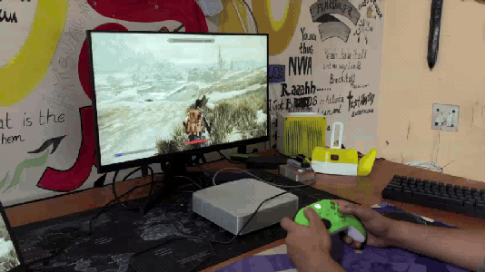

For the final phase in this small project, we installed Steamlink using Pi Apps, connected our laptop to Steam, and ran a few games, including HALO 4, Silent Hill 2 Remake, and even OG SKYRIM.
The Pi CM5 handled everything we threw at it. Games are not running directly on CM5, but on our PC, Steam is streaming them via Compute Module 5, and they are working well, as demonstrated by the Gifs and linked youtube short.
