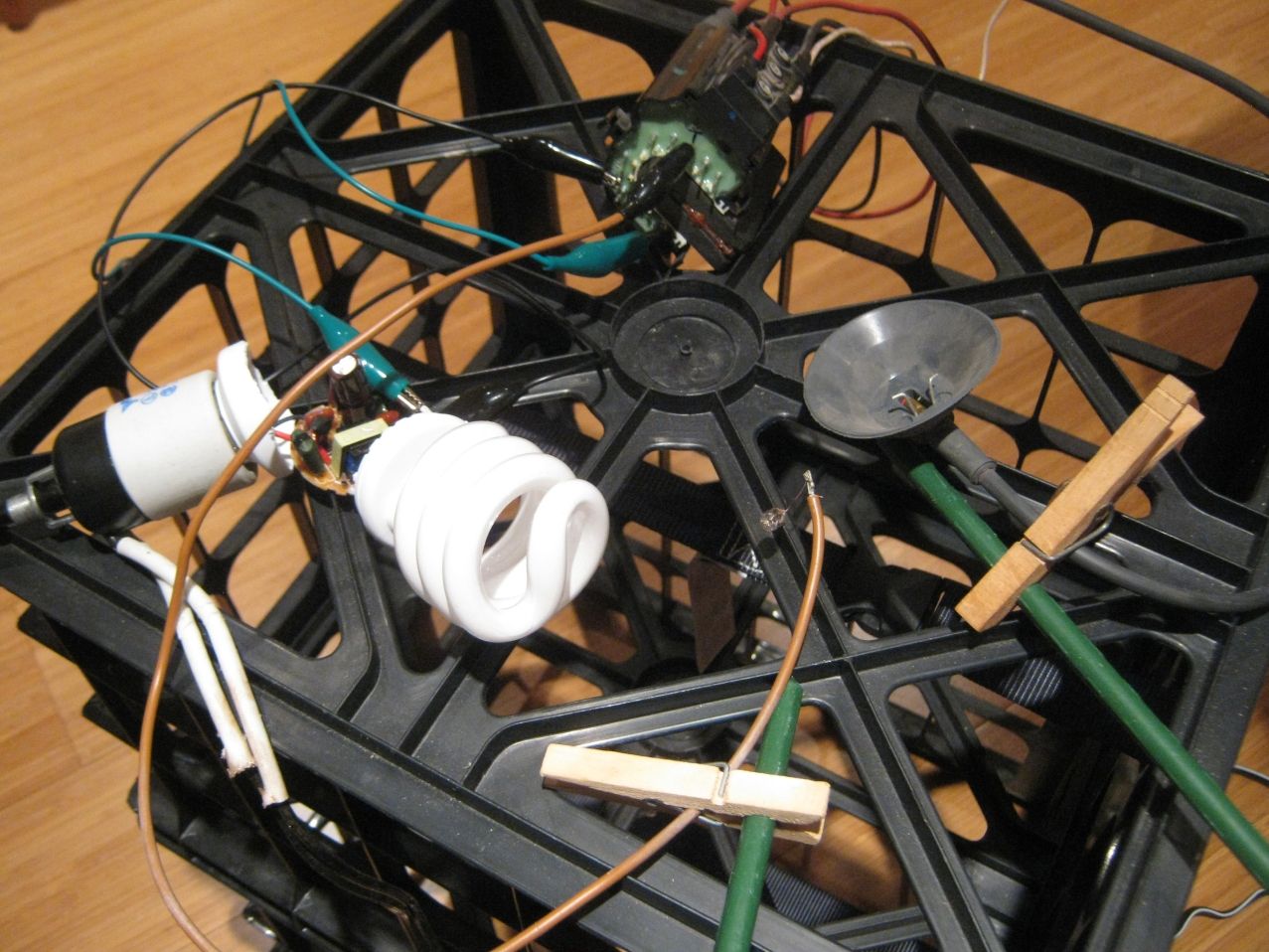

Step 3: The Finished Setup
This is how the finished high voltage supply looks like.
Remember, this is a DC supply. The output from the thick wire is positive. In TVs and CRTs this high voltage output drives the negative electrons from the filament to the screen.
If you need AC high voltage, you have to remove the built-in diode or find an old flyback transformer that does not have a built-in diode.

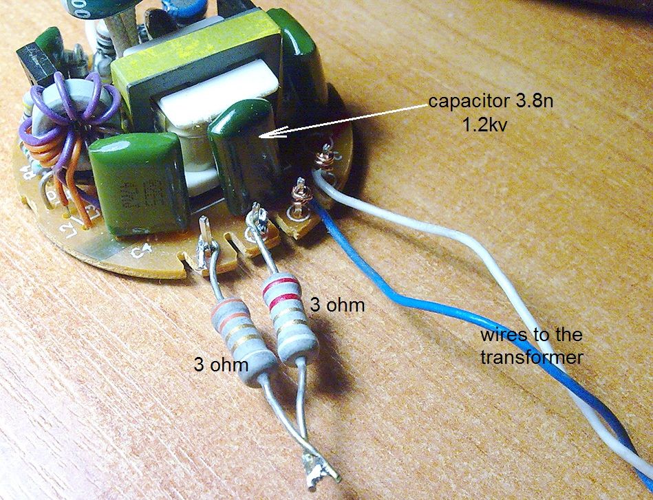

Step 4: Troubleshooting
The first time I build the circuit, it worked immediately. I used a 26 watt CFL.
Then I decided to get a bigger CFL and I build it exactly like the first circuit. It didn't work. I was disappointed. I thought that the CFL electronics were shot.
But when I reconnected the fluorescent tube to the four wires, the CFL worked again. I realized that this type of CFL circuit needed to "sense" the filaments in order to operate. Remember, I was only using the outer wires and leaving the two inner wires alone.
So I put a resistor across the outer wire and the inner wire. The circuit worked! But within seconds the resistor was in flames.
So I decided to use a capacitor in place of resistor. The capacitor allows AC currents but blocks DC while a resistor allow both AC and DC currents to flow through it. Also a capacitor does not heat up because it provides a low resistance path for AC currents.
The capacitor worked great! The arcs produced were very big and thick.
So in summary there two things that can go wrong:
1. You wired it wrong, either on the CFL side or the flyback side.
2. The CFL electronics needs to sense the filament and you can use a capacitor as a substitute.
Use a high voltage rated capacitor. Mine was 400V and I got it from another CFL circuit.

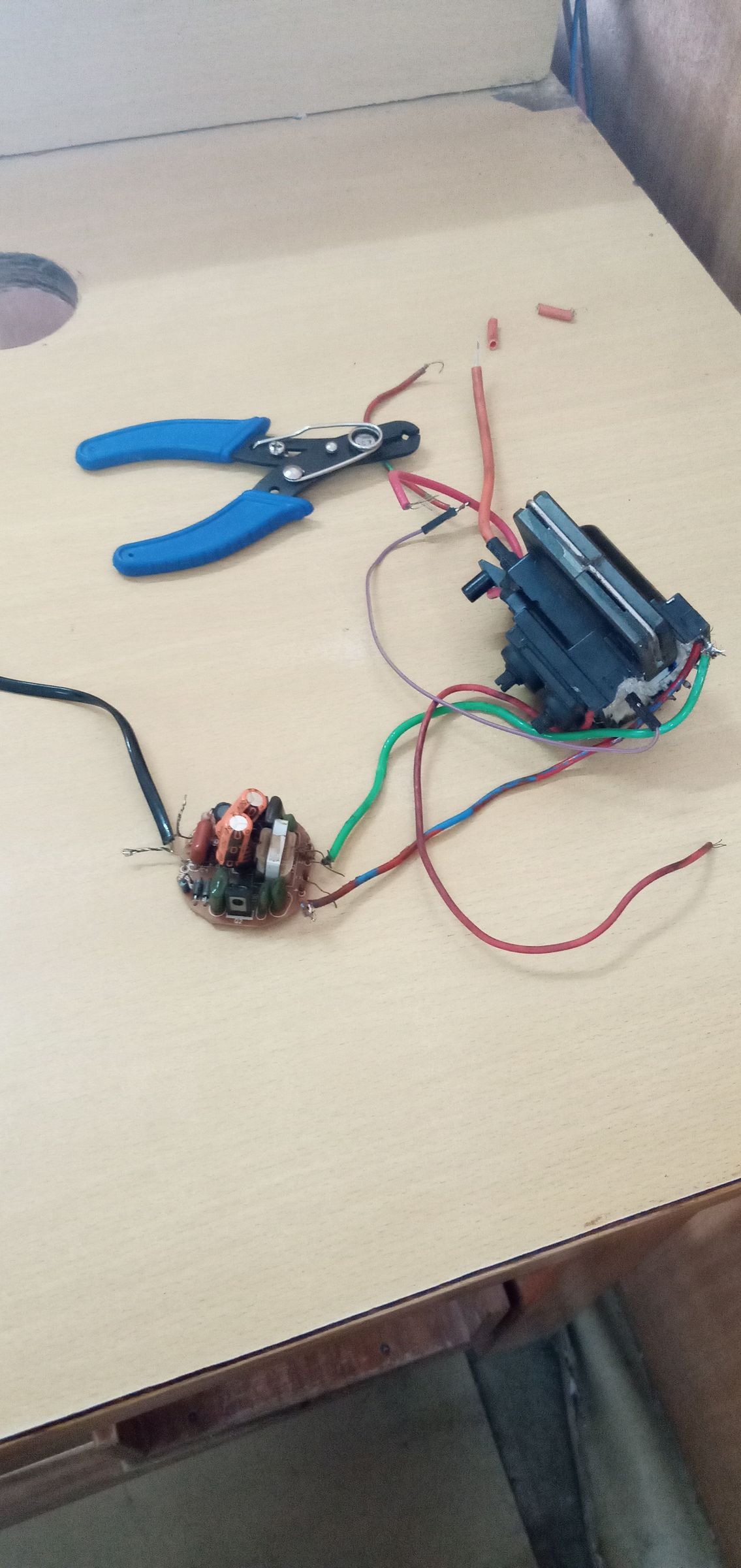

drugpacan
drugpacan
4 years ago
The mistake was that I connect the transformer to the extreme conclusions from four to CFLs. I measured the resistance of the filaments of CFL lamps. It turned out each strand has a resistance of 3 ohms. Thus, the total resistance of the two strands was 6 th. I have created a semblance of snubber 6 ohm resistance + series capacitor 3.8n 1200 volt and transformer connected. Since the capacitor on the board already exists, between two close-pin soldered resistance 6 ohms, and the transformer took another couple of conclusions. If the CFL 26 watts of power, the arc starts at a distance of 4 centimeters and is very noisy, blue and red and thick. If the CFL power 11 watts, the arc starts at a distance of 2 centimeters. If the distance is increased to 4 centimeters, there is a glow discharge and begins to secrete large amounts of ozone

3 years ago
Ok i builded it,and i used a resonant capacitor but it consumes a lot of power and full bridge capacior just exploded,i don't recommend to use capacitor from CFL circuit,try to use a lower capacitance capacitor and install a safety spark gap to discharge HV ripple to avoid damaging the oscilator.
