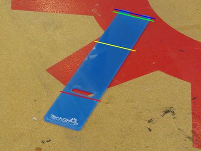

Step 3: BEND THE FLAT USING THE HEAT STRIP BENDER
Turn on the heat strip bender, set it to maximum temperature and let it warm up for ten minutes or so. You are going to make a series of four bends, starting at the end farthest from the TechShop logo.
Important: Before using the heat strip bender, you need to remove the protective backing from the acrylic flat.
Bend #1
Place your acrylic flat on the heat strip bender so that the blue line in the first photo is over the slit. Wait a minute or two for the acrylic to soften, then make a 90 degree bend as shown in the second image. Hold the acrylic sheet in place while it cools.
Bend #2
Place the acrylic on the heat strip bender and start softening it at the point marked with the green line in the first photo. Once the acrylic has softened, make another 90 degree bend the same direction at this location.
Bend #3
Set the angle bender to 35 degrees. Place the acrylic on the heat strip bender so that the area indicated by the yellow line is over the slit. Once the acrylic has had time to soften bend it against the angle bender as shown. Allow the acrylic to cool completely before proceeding.
Bend #4
Set the angle bender to 75 degrees. Place the final bend (indicated in the photo by a red line) on the heat strip bender. Once it has warmed up, bend it on the angle bender as shown. Hold the piece firmly in position while it cools (and hardens).
That's all there is to it. You've completed your phone stand.
