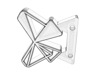

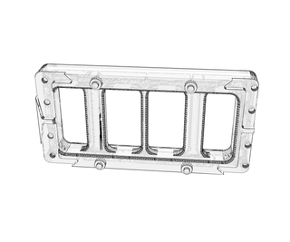

Start printing the center frame
Thee center frame is better to print like you see in the image, the final object will structure his self, and the print will be more concentrate in a shorter space of the resin tank because of the clouding of rasin tank.
Note: always use the back of the objecto to print to recive the support

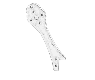

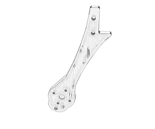

Printing the wings
You have 2 files, “wings 1” and “ wings 2”
note: You must print 2 of each file, to assemble
Because of the clouding of resin tank we must change the locations of the print object, so this print´s we will move out of the last print as possible. (see the image)

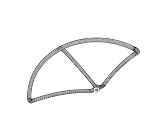

Printing the propellers protection
See the image for positon tip, don´t forget to move the location of all prints

Step 5: ASSEMBLE THE FRAME
Note : Printing with the form1+ will let you print the hole and use a screw to assemble all parts of the frame.
The frame was designed with holes already spaced to match the motor mounts.
Use an m3 thread-cutting screws designed for plastics to assemble the frame
http://formlabs.com/en/company/blog/2014/11/25/add...
I give colours to each part to help you understand
Start to assemble blue with black (wings + center frame)
at the front, you have 2 screws that sould be bigger so you could assemble yellow, blue and black ( fablabs logo + wings + center frame) with the same screw.
note: leave the propellers protect assemble to the final

- Attach 2 loop of velcro to the 2 big crossbar´s ( see the image,) on the center frame, do it so you could assemble the battery under the frame, using the 2 loop of Velcro.
Note : the loop of Velcro is held by using 2 zip ties on the crossbar
- Attach the kk2.0 board to the frame

- attach the propelers protector with a screw to the wings frame
