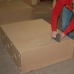

Step 2: Assemble Main Section
3. Assemble the shelves and dividers as shown in the diagram, working from the middle section. Pre-drill 3mm countersunk pilot holes through the shelves to attach the dividers. The holes can be filled in with wood filler and then sanded smooth. The bottom shelf is attached later on.
GOOD TO KNOW: We marked for the top and bottom sections at 300mm in, and the centre shelf at 250mm in, but you can adjust this as required.
4. Secure by pre-drilling countersunk pilot holes through the top of the bottom shelf into the base apron.
5. Now attach the base assembly to the assembled shelf sections by pre-drilling countersunk pilot holes through the bottom shelf and into the bottom divider.
GOOD TO KNOW: The base apron is attached to the bottom shelf at 5mm in from the front edge of the shelf. This gives the base a nice finishing touch.
6. Attach the sides to the base and shelf sections by pre-drilling countersunk pilot holes through the side into the shelves.
7. To finish the main section, attach the top by pre-drilling countersunk pilot holes through the top into the sides.
IMPORTANT: Before attaching the top to the sides, drill three [3] countersunk pilot holes through the underside of the top in order to mount the roof section.
8. Fill all holes with wood filler, let dry and then sand smooth.

10. We used 3mm MDF for the backing board and this will be painted with the assembled project, but you could also use 3mm white masonite and add this once you are finished. The back is stapled in place - or use a hammer and panel pins.
