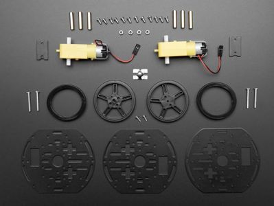

I paired the Cytron board with an Adafruit Mini 3-Layer Round Robot Chassis Kit - 2WD with DC Motors and an Infra-Red remote kit bought on Ebay (remote, IR sensor, IR LED and cable).
Step 1: Assemble the Chassis
There are no instructions with the neatly packaged chassis but it is easy to assemble if you lay out all the parts in a logical manner before you start. I had to gently file a couple of the tongues to get them to fit neatly into their slots.
There are plenty of holes to fit extra components but I’ve found that they seldom line up with holes in the bigger boards you try to attach. I used Blu Tack to fit the battery box (4xAA) to the top layer and then the microcontroller board on the top. Worked well, enough grip and very easy to adjust/remove as you modify your design and add more components.

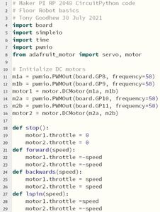

Step 3: Basic Robot Program - Part 1
This imports the the necessary libraries, sets up the motors and defines routines to move the robot forward, backwards spin left and stop.
Step 4: Basic Robot Program - Part 2
This part defines a right spin and turns to the left and right about stationary wheel.
The final section calls each of these actions in turn to carry out a basic test.

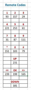

Each press of a remote button should provide a list of 4 numbers. I decided to use the 3rd number as the code.
Running the program provided these numbers to represent the keys.
Step 7: The Codes From My Zapper
I decided to use the following buttons on the remote to control the robot.
2 to Halt the program
UP to go forward
DOWN to go backwards
LEFT and RIGHT for spins
* and # for turns
OK for Stop

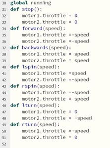

Step 10: Final Program - Part 2
These are the motor control routines.

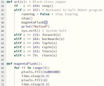

Step 11: Final Program - Part 3
Sorting out and applying the code from the remote and a routine for the final magenta flashes.
Step 12: Final Program - Part 4
The main loop: it receives signals from the remote and passes valid code to the action routine coded earlier.
