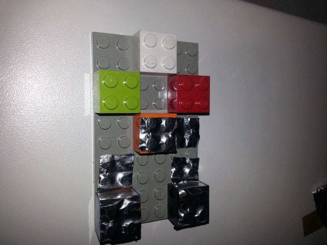

Step 2: Build Your Lego Controller
In this step we're making our lego controller, I won't add to much text here as the pictures outline the steps.
We need six buttons.......Up, Down, Left, Right, Fire, Action!

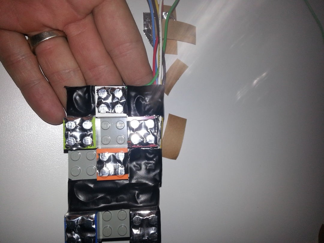

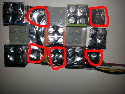

Step 3: Tape It (Pt. I)
Using small strips of foil tape(3.5cm length x 1cm width), cover the buttons on the lego controller as pictured.
NOTE: Be careful when applying the foil tape, any tears or holes will result in poor connectivity during game play. Take your time, double check your buttons to ensure they are covered completely. Last thing you want to do when playing a first player shooter game is have your firing button malfunction due to a tear or short in the foil tape. We want to kill as many aliens as possible, and achieve our victory over the alien scum!

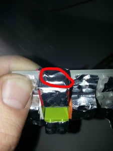

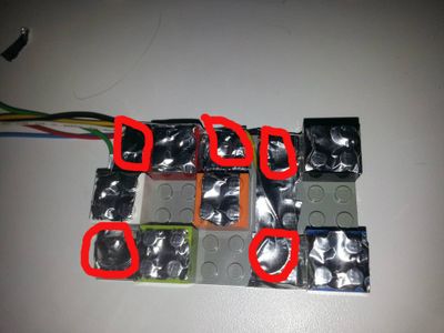

Step 4: WIRE IT (Pt. I)
Now we need to connect our solid core wire to our foil tape covering our buttons with extra foil tape to make a good electrical connection.
First if you haven't already, strip back 5 to 6 cm of insulation exposing the solid wire inside.
Next loop the end of the wire in a circle pattern. We do this to maximize the surface area the wire is making contact with the foil tape.
NOTE: Lego's are great for prototyping, but the dimples on top of the buttons sometimes can be a bit troublesome if your wire falls in between the dimples during gameplay. Best to keep it on top of the dimples as outlined in the pictures.

Step 5: Tape It (Pt. II) Adding an Insulator...Electrical Tape (Optional)
Now we're going to add electrical tape to help decease our risk of electrical shorts during game play and add a extra layer to help hold down our foil tape to the lego board. Again this is an optional step, but I think it warrants the time.

Step 6: Adding Ground
Of course we have to add a ground connection to complete our circuit, and we're going to do this by adding some electrical tape to the back of our lego controller. Next we'll add our strip of foil tape 7cm or so will be good enough for our purposes on top of the electrical tape.
Now strip back about 5 or 6cm of insulation from our last solid core wire and add it to the foil tape on the back of the lego controller. Try to keep the wire straight, we want to have good coverage on the foil tape with the solid core wire.
NOTE: Make sure when covering the wire you don't cover all of the foil tape. Notice in the picture I cut the foil tape in half width wise before i covered the wire. If you cover the foil tape completely you wont be able to make contact with the foil tape under the wire, and that's wear our electrical signal resides, so we need to make sure we can touch it to complete the electrical circuit.

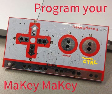

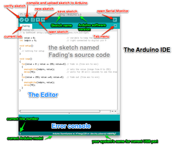

Step 8: Load Our Code
So in order for us to use our MakeyMakey to kill aliens, we'll first have to define the keys we need and communicate that to our makeymakey board... We'll do this by using the arduino software to flash(program) our makeymakey with the keystrokes we need.
How to use the arduino software:
https://www.instructables.com/id/Beginner-Arduino/ or http://arduino.cc/en/Guide/HomePage
How to re-program your makeymakey check out these great instructable:
https://www.instructables.com/id/Re-programing-the-...
https://www.instructables.com/id/Program-your-Makey...
I won't cover actually programming the MakeyMakey, but I'll provide my updating key mappings for download.
Forward, Back, Left, Right, Fire, Action are the keystrokes we need to tell the MakeyMakey about.
In our version of Doom we will use the 'Crtl' key for Fire and the 'Spacebar' for Action.
Directional Keys will refer to our arrow keys on the MakeyMakey board.
Download the Script here

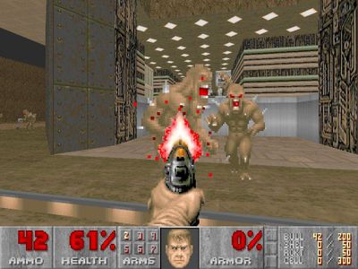

Step 9: DOOOOOOOOOOOOOOOOOOOOOOOOOOOM
website: http://www.classicgamesarcade.com/game/21692/doom.html
Make sure your lego controller is connected to MakeyMakey and Computer. Press space button to start the game. Enjoy!
NOTE: Press F1 for a list of Commands
