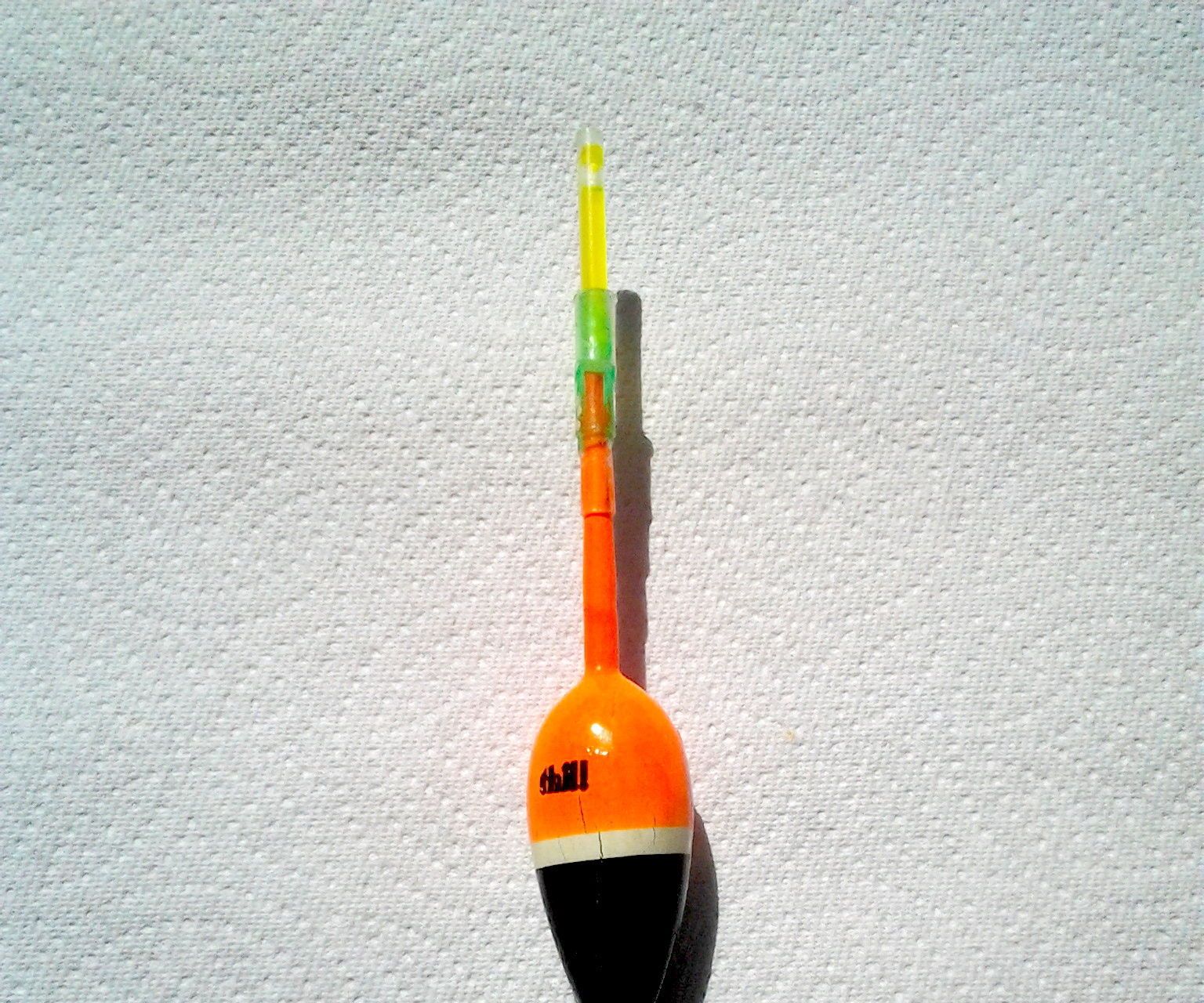

Then another thought hit me. I've been using plumbers epoxy putty for fabricating missing pieces lately. My wife's fishing pole had a broken piece on it and I used epoxy putty to fill in the missing pieces. It was the part that holds the reel to the rod. I'd never used epoxy putty before and I was surprised at how *AWESOME* the stuff is. It worked perfectly and is almost as strong as metal. So I then used it to fabricate a missing hinge part which holds an axle for a clasp on my tackle box. And it's held strong. Color me impressed.
Epoxy putty is damn manly stuff. It's instantly gone to the top of my favorite manly materials list. Some kinds of epoxy putty actually have metallic powder in them, so they are partly metallic. If you've never used or seen the stuff before, I *HIGHLY* recommend you get a stick of it. It's simply awesome stuff! It's available in the hardware section of just about any store. I've found it at HomeDepot, Lowes, Ace, W*lmart, and even hobby stores.
