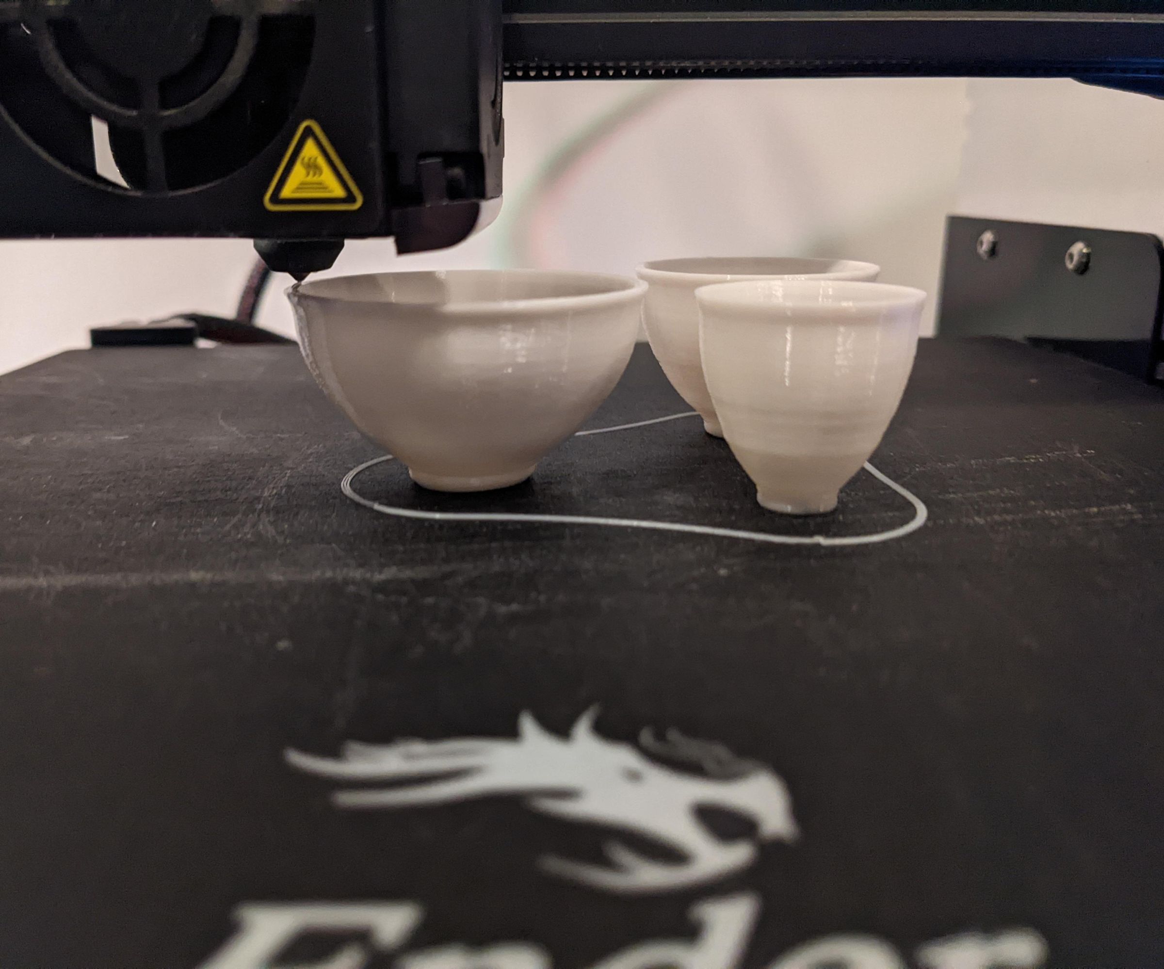

Step 3: Geometry Design - Slicing Tests
For the parametric design of the lamp, the original idea was about geometry and flowers because the design of the lampshade looks like a flower stem. I modified some parameters from the provided python module inside Grasshopper to get more "waves" over the X,Y,Z axis and also a more "broken" symmetry. While trying to figure out the final shape, I had to export several versions and slice them in Cura in other to figure out which out was more efficient and would have a better result. I started with not so many subdivisions, but eventually, they were more or less the same time for each lamp.

Almost 10 hours of printing but it was totally worth it! The first test print was with the basic white PLA but the final implementation was with the blue UV reactive PLA. The lampshade is white by night and blue by day!
