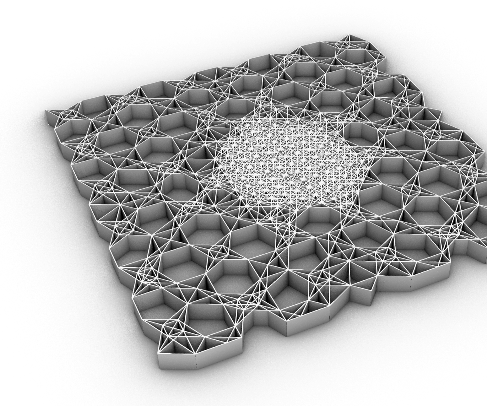

Step 2: Replacing the "Hair Points": 2D Woven Pattern
This time I alternated the sine waves to create a 2D pattern. It is like a checker pattern, but instead of 2 different colors, I have 2 different densities.
The final print did not have the effect I designed for. I think this is due to 2 things:
1. I focused on alternating the densities on the horizontal hairs (the sinusoidal curves), however the pattern is effected by the pillars, as well. The pillars are following a 1D pattern unlike the hairs. See the photo of the final print.
2. The amplitudes of the sine curves that form the hairs are too small, so they all seem somewhat tight and kind of uniform on the horizontal level, even when the frequencies vary.
Update:
I addressed both the problems that I mentioned. See the screenshot with the uniform pillars. Running a print now.
