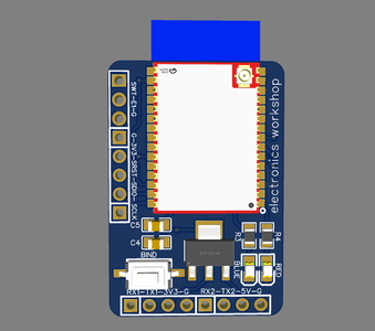

Step 6: Schematic Diagram

In conclusion, this project presents a robust and efficient dual-band telemetry communication system built around the E77-900M22S and E28-2G4M27S LoRa modules. It is specifically designed to support long-range, low-power wireless data transmission, making it highly suitable for applications like MAVLink-based drone telemetry, remote sensing, or IoT deployments. The integration of both sub-GHz and 2.4 GHz bands offers flexibility—balancing range and data rate—while onboard UART, SPI, and SWD interfaces ensure easy development, debugging, and system integration. Overall, the design demonstrates a scalable and adaptable solution for reliable, real-time communication in embedded wireless systems.
