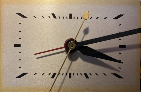

- Take a picture of the original clock face that we want to reproduce [Picture 1].

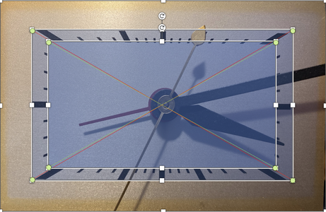

- Add temporary bounding boxes [light blue - Picture 2] over the clock face graduations (marks). Draw some lines to find the center. Remove the bounding boxes.

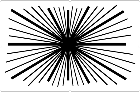

- Add lines that cross the original picture's graduations. I used different colors, temporarily, to help keep track of the different thickness graduations. [Picture 3, background original clock image removed for clarity]. Change line colors to black (or other color) [Picture 4].
- Mask out the graduations shapes with white rectangles [Picture 5].
- Group all lines. Add center circle, which will be cut out for the clock mechanism [Picture 6].

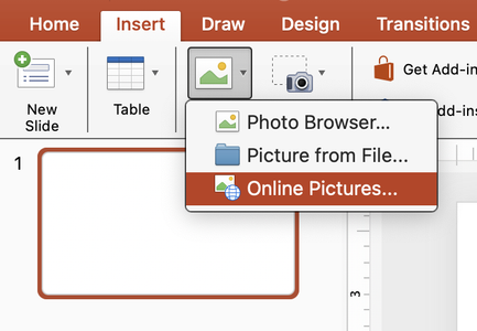

Import this PNG with Alpha channel into Powerpoint. Insert a picture for the clock face background, for example Online Pictures [Pictures 4, 5, 6]. Send the background picture to the back, Arrange->Send to Back. The clock face artwork should look something like Picture 7.
