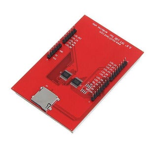

  1. MCU Friend Parallel Display
  2. Arduino Mega 2560.

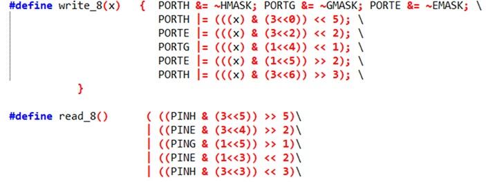

  1. The MCU Friend Arduino library screenshot shows the inefficiency of Arduino Mega connections compared to Uno connections. This is the result some functionality on the ATMega328 (Arduino UNO) is shifted to other ports on the ATMega2560 (Arduino MEGA2560). From software perspective, the UNO vs. MEGA compatibility on D8 ... D13 is most likely quite OK, but it makes the pins unsuitable as LCD_D? pins since the data is mixed over too many hardware resources.

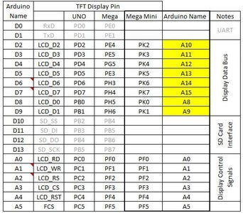

Step 2: LCD Bus Compared
The table shows how Arduino pins D0....D9 and A0...A4 are used to connect to the MCU Friend parallel display.
Clearly visible:
  1. UNO connection requires two I/O ports, no bit positions are shifted. So LCD_D0 is connected to the 0th bit of the I/O Port. This goes up to LCD_D7, being connected to the 7th bit of the same I/O Port. That way, there is no need the software has to shift or distribute data over multiple I/O ports.
  2. Mega has the same connection in terms of position. But that connector is routed to an additional I/O port. Besides that, the bit positions are shifted. As a result, the AVR core has to start shifting data on top of the bit masking, making the display access on Mega considerable slower.
Some searches claim the F_CS pin is related to the touch interface, but a brief examination of the driver source code did not give any indication this pin is actively used (for this reason I consider Arduino A5 unused by the MCU Friend display).

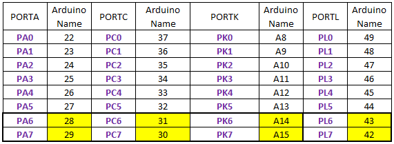

Note other complete ports available to the Arduino Mega are PORTA, PORTC and PORTL. For convenience, I list below the Arduino Digital number as Name. The touch interface access changes according to the port used by LCD_D0 ... LCD_D7.
Step 5: Alternative Mega Ports
The table shows what other complete ports are available on Arduino Mega: PORTA, PORTC, PORTK and PORTL. Using a complete port with each bit directly connected does not require software intervention to put it at the correct spot. The only disadvantage of a complete port is that you also use the functionality. For that reason, I didn't list PORTE, since it contains the UARTs and usually at least one is required for debugging / PC connection. The yellow marked pins are the alternative digital IO pins for the touch interace (see step 4).
