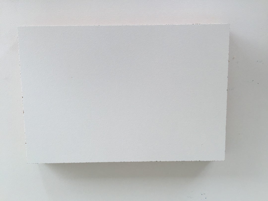

MDF pieces - You can buy as you need, I simply but twice the need so I had backups =). I bought 15mm thick
1 piece of 64cm x 59cm MDF for the panel As many pieces as you need of 10cm x 15cm MDF board for the shelves

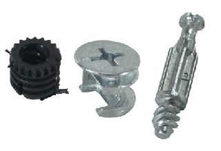

Screws - In Brazil these screws are called Girofix / Minifix. I chose to use these ones because I want it to be somehow flexible - I know I wont be prettier if decide to change... but I work with IT.. can't help =)
You´re gonna need 2 screws per shelf. I also used some drywall screws and sleeves.

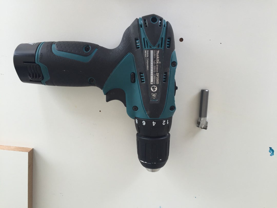

Tools - Screw Driver (in my case I used PZ2 and PZ1 bits) - Drilling machine - 10mm, 8mm, 5mm and 3mm drills - 15mm mill - Wood Holders - Pencil - Ruler - Paintbrush - Utility Knife

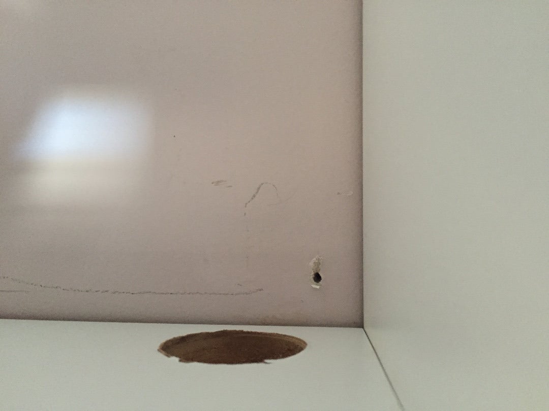

In the first step I prepared the place I was going to put my tools. I had a place below my desk in my office, so I decided to use it. I know the panel should be handy, but the idea here is just to

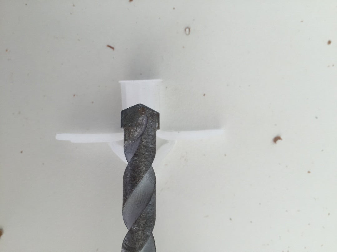

store and make them visible. To make sure everything was going to fit, I made a hole with a 3mm drill in the board and continued after it reached the wall, then I removed the board and drilled the drywall with the 10mm drill.
I also drilled the board 10mm with a 5mm drill so I could hide the holes.

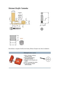

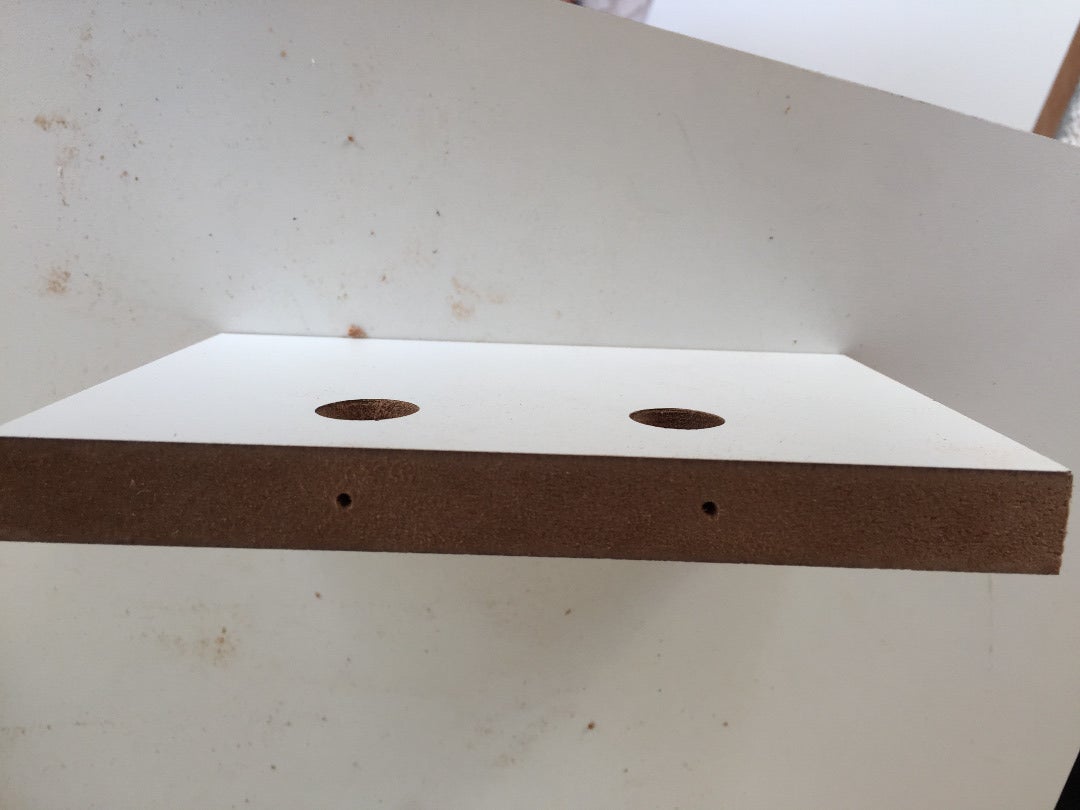

Well, now it's time to use the Girofixes. For this step you're gonna follow the girofix instruction (pic 1).
So you're going to need the 15mm mill, 10mm and 3 mm drills and some clamps. Since my shelves have 15cm each, I decided to drill each drill 5cm far from the other. Since you're using MDF it's important to drill the hole entirely with a 3mm drill before doing the big hole or the piece will crack.

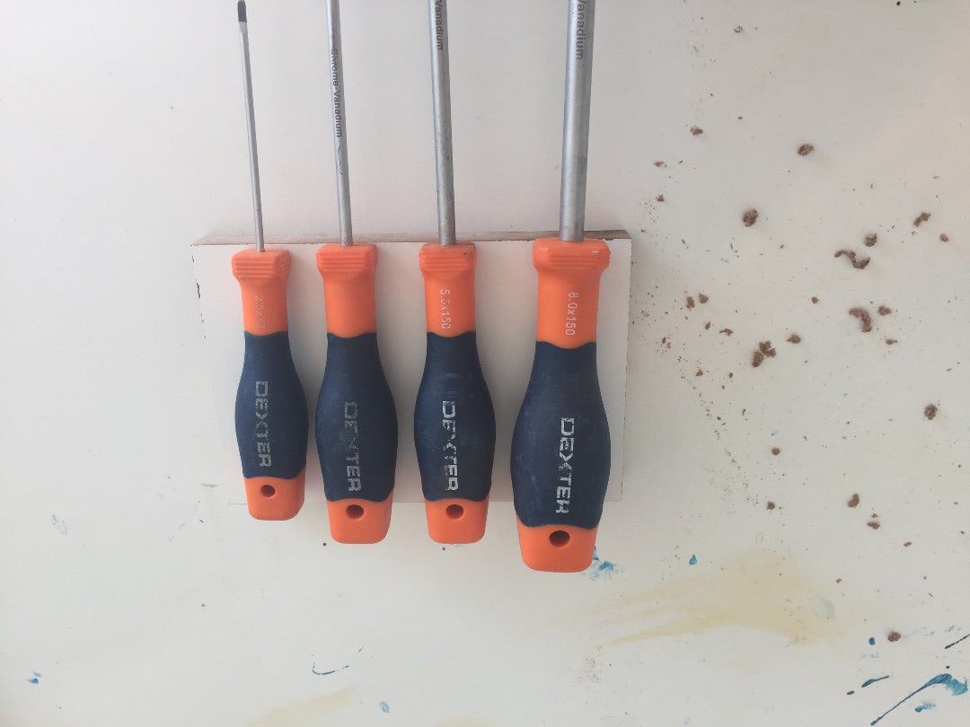

Well, we all have different tools, I decided which ones were most important for me. It's clear that I don't have all that skill with wood work and I also don't have all the tools needed. But you can see some examples of customizations I did. Everything I used were my brave screwdriver, some drills, clamps and a lot of will =).
Just make sure you won't make a hole where the girofix are and you will be fine.
