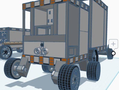

Step 1: Designing MediBot With Tinkercad

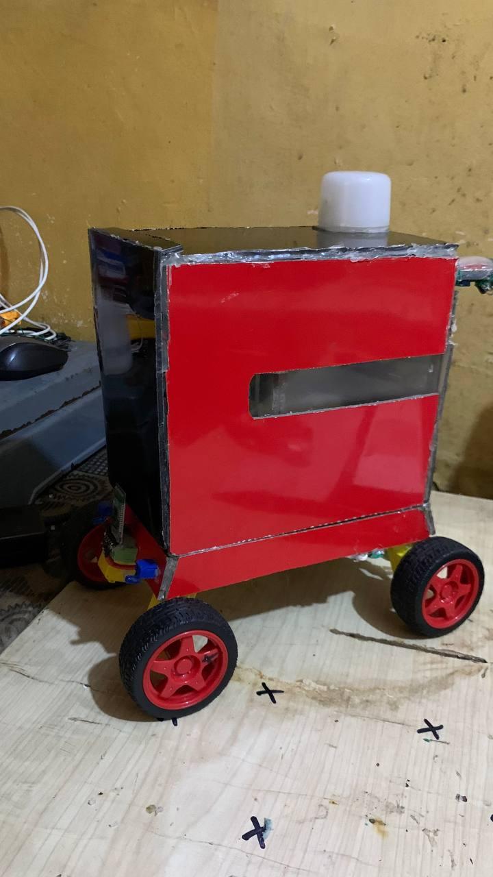

The next step in the project was designing the 3D structure of the bot using Tinkercad. Tinkercad, being a beginner-friendly yet powerful 3D design tool, allowed us to visualize how the bot would look physically. This step involved creating a virtual prototype, defining the placement of key components like sensors, LEDs, the sanitizer module, and the structure housing all these elements.
Using Tinkercad, we designed the overall framework of the bot to ensure it was compact, efficient, and aesthetically pleasing. The virtual model also helped us assess the spatial arrangement and accessibility of all components, ensuring that the wiring and hardware placement would align seamlessly in the physical build.
This 3D design served as the foundation for assembling the physical structure, providing a clear and organized layout for mounting all the electronic and mechanical components.

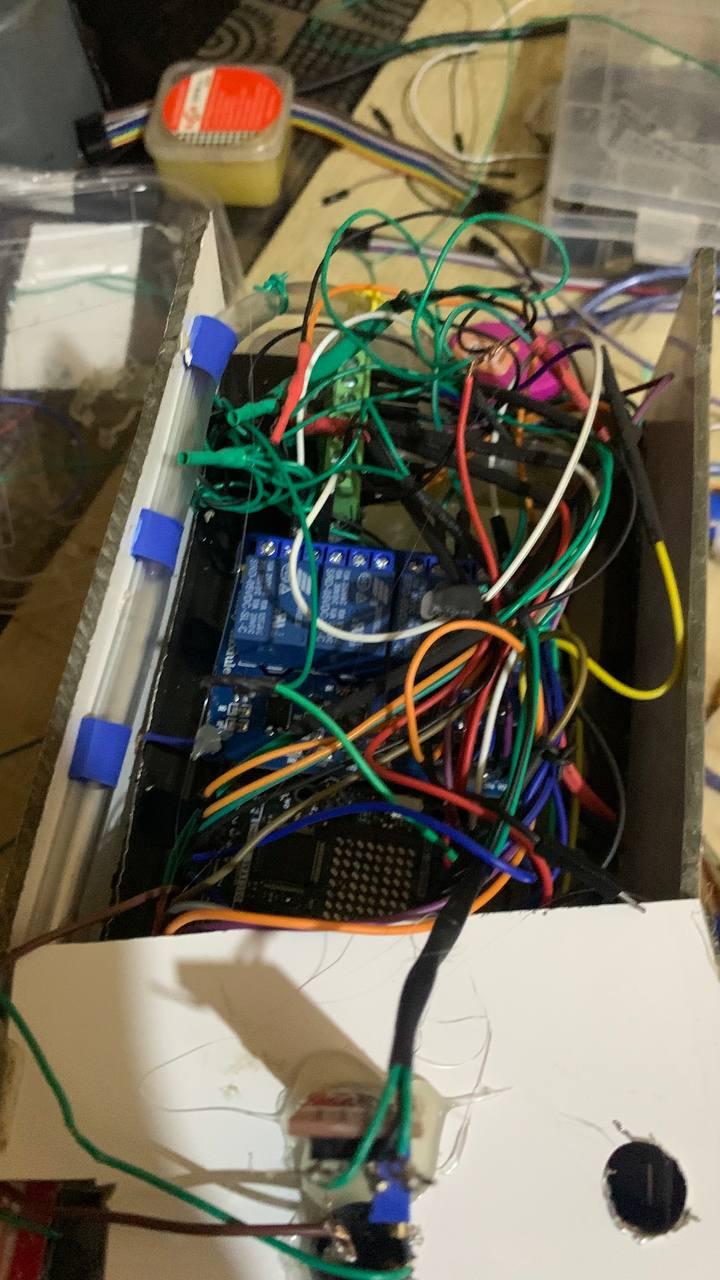

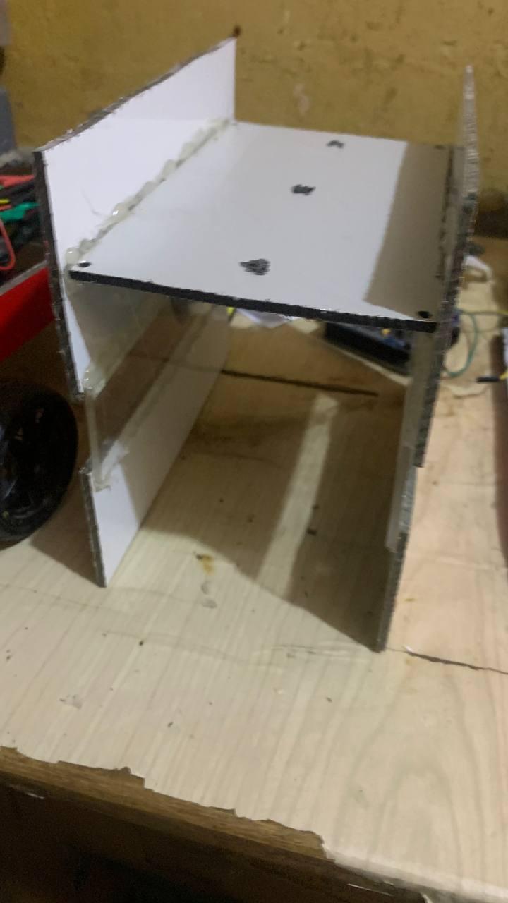

Step 2: Build Medibot Using Locoboard and 3D Design
In this step, we will assemble the Medibot using a Locoboard (a modular board for easy construction) and follow the 3D design to ensure proper placement of all components. The goal is to have a sturdy, functional robot with all components securely mounted.
  1. Assemble the Locoboard Structure:
  2. Start by gathering all the parts of the Locoboard that you’ll be using for your robot's frame. Ensure you have all the connectors, panels, and mounting brackets that come with the kit.

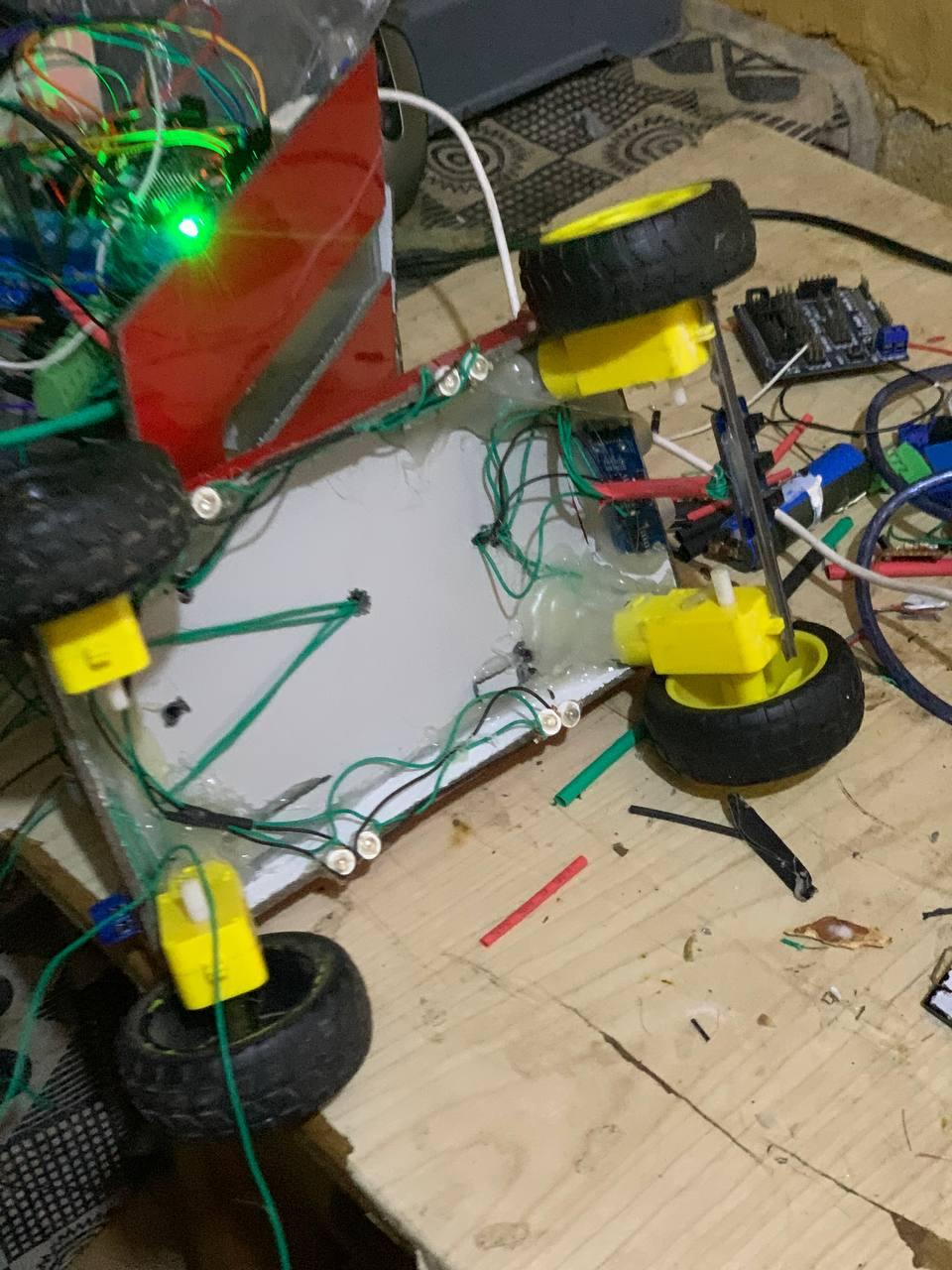

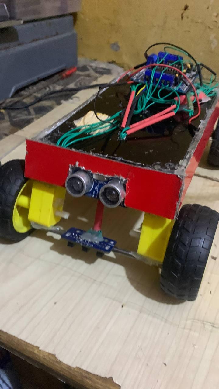

  3. Build the base of the robot following the 3D design for the correct dimensions and layout.
  4. Secure the motor driver, motors, and wheels to the base of the Locoboard using the provided screws or brackets.

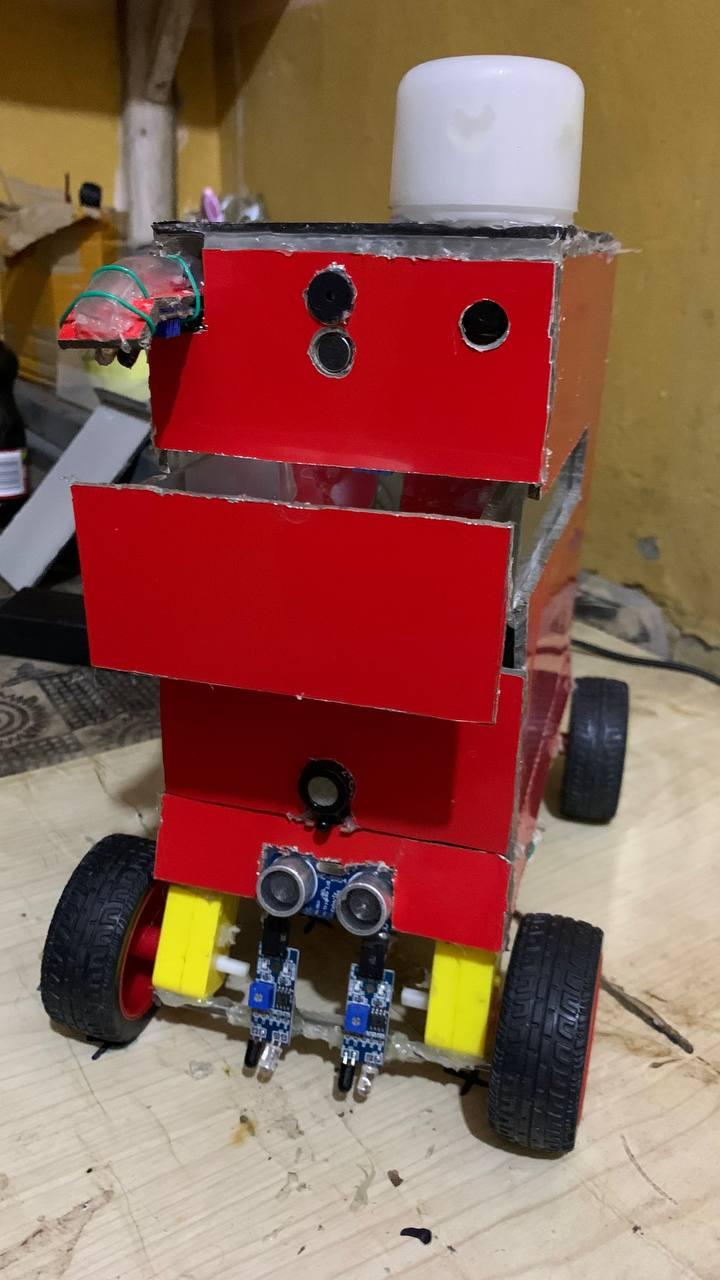

  5. Mount the Sensors and Components:

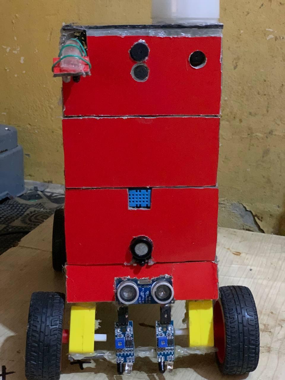

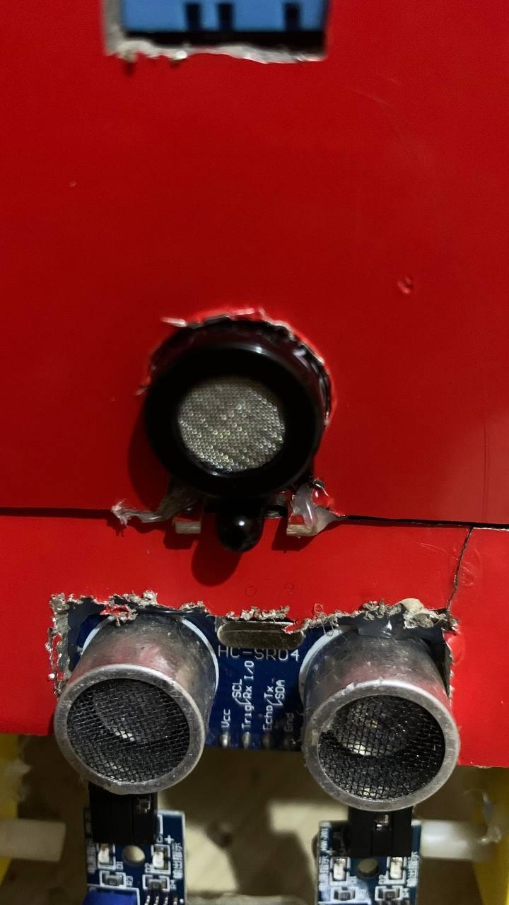

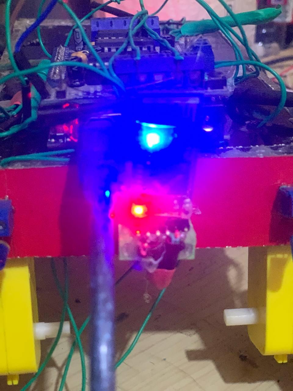

  6. Mount the Ultrasonic Sensor (HC-SR04) on the front of the robot for effective obstacle detection, ensuring it faces forward and is slightly elevated.
  7. Position the IR sensors close to the ground for accurate line-following capabilities, securely fastened to avoid misalignment.

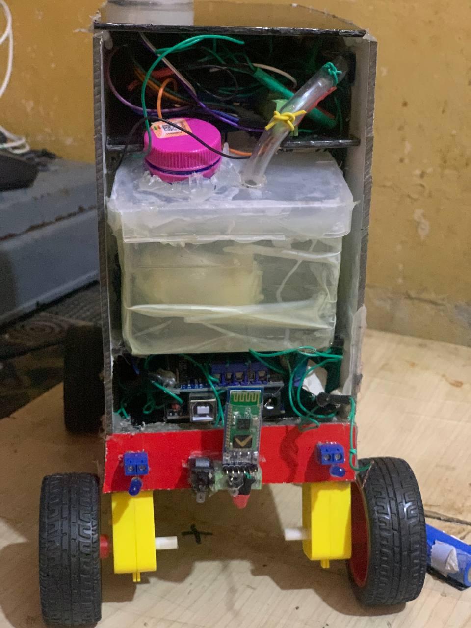

  8. Attach the Bluetooth module (HC-05 or HC-06) where it can communicate effectively with your control device (smartphone/laptop).

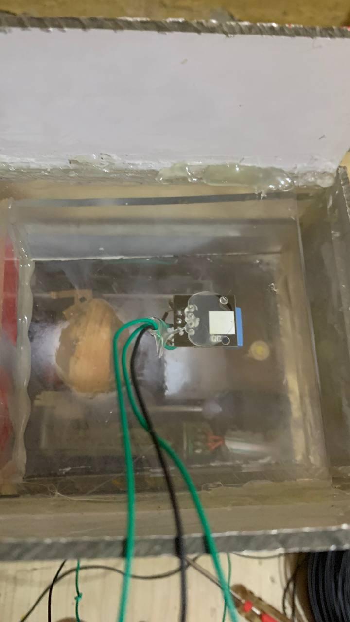

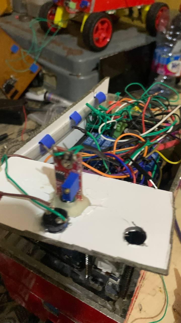

  9. Mount the MQ-7 Air Quality Sensor on the upper part of the robot’s body for proper airflow and accurate air quality readings.
  10. Position the Flame Sensor on the front or top section of the robot, ensuring it is pointed at an open area for flame detection.

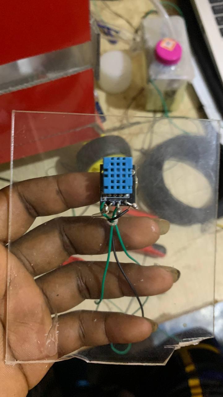

  11. Attach the DHT11 (Temperature and Humidity Sensor) where it won’t be obstructed, ensuring accurate readings.
  12. Place the Sound Sensor where it can detect noise effectively, preferably in a raised position for better detection.
  13. Position the LEDs at visible locations for real-time feedback on the robot’s status.

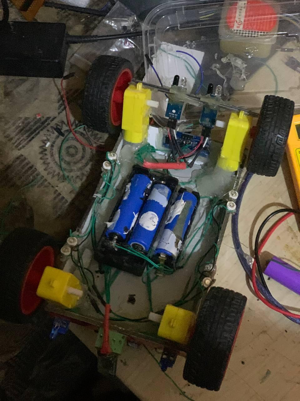

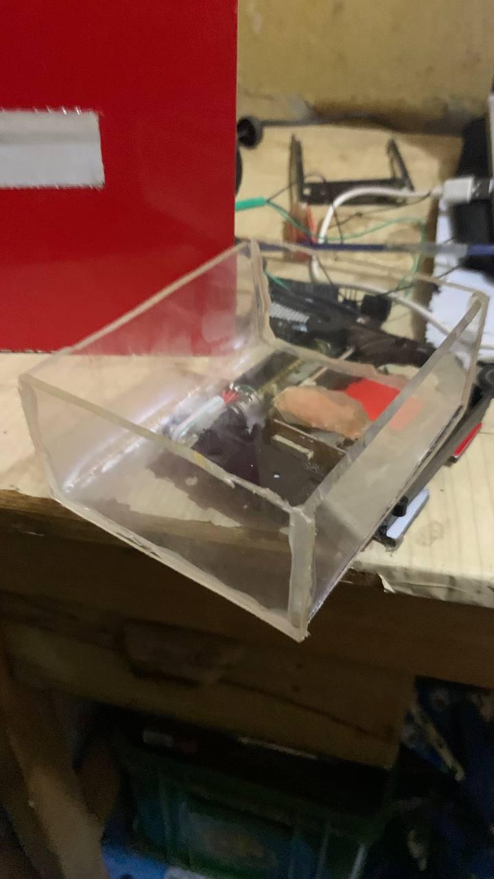

  14. Secure the Power Source:
  15. Place the power source (either a 9V battery or rechargeable Li-ion pack) in a secure compartment on the robot, preferably near the center of the base for balance.
  16. Connect the power lines to the Arduino and motor driver to provide power to the system.
  17. Ensure Stability and Safety:
  18. After mounting all components, check the stability of the robot. Ensure that the wheels are properly aligned and the sensors are not obstructed by other parts.
  19. Make sure all wires are securely fastened and won’t get caught in the wheels or motors during operation.

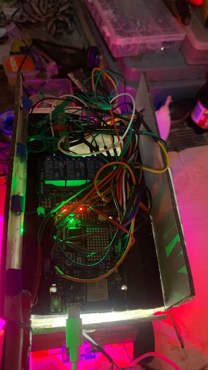

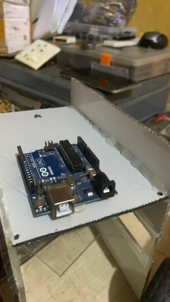

The schematic organizes the Medibot’s components into sensors, actuators, relays, and communication modules. Each device is connected to the Arduino Uno board based on the specified pins in your code.
1. Microcontroller: Arduino Uno R4
  1. Central to the Medibot, the Arduino Uno manages data collection from sensors, processes it, and controls actuators and outputs.
  2. The Wire library handles communication with connected modules like the IoT cloud.
2. Sensors and Their Connections
  1. DHT11 Temperature and Humidity Sensors (x2):
  2. Used to measure temperature and humidity at different locations.
  3. Connected to:
  4. Sensor 1 (DHT1_PIN): Digital pin 4
  5. Sensor 2 (DHT2_PIN): Digital pin 5
  6. Data type: Digital signals.
  7. MQ-7 Gas Sensor:
  8. Detects carbon monoxide (CO) levels and calculates Air Quality Index (AQI).
  9. Connected to:
  10. Analog pin A0
  11. Analog input is used for voltage reading and further processed to calculate ppm and AQI.
  12. Sound Sensor:
  13. Monitors environmental noise levels.
  14. Connected to:
  15. Analog pin A2
  16. The analog signal is converted into decibels (dB) using the reference voltage.
  17. Flame Sensor:
  18. Detects flames or fire in the vicinity.
  19. Connected to:
  20. Digital pin 6
  21. Reads a HIGH or LOW digital signal to determine the presence of fire.

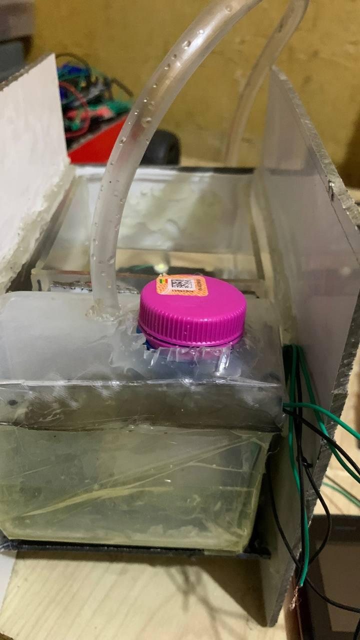

  22. IR Sensor for Sanitizer Activation:
  23. Detects objects (e.g., hands) in proximity for activating the sanitizer.
  24. Connected to:
  25. Digital pin 10
  26. The output (HIGH/LOW) triggers the relay controlling the sanitizer dispenser.
3. Actuators and Outputs
  1. Relay Module for Various Functions:
  2. Disinfection Light: Connected to pin 7
  3. Front Light: Connected to pin 8
  4. Medibot Light: Connected to pin 11

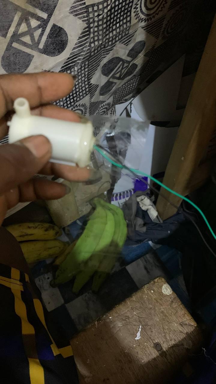

  5. Sanitizer Dispenser Motor: Controlled via a relay connected to pin 12
  6. Buzzer:
  7. Emits sound alerts for harmful gas levels, flame detection, or other hazards.
  8. Connected to:
  9. Digital pin 9
  10. Green LED:
  11. Indicates the sanitizer system's idle state.
  12. Connected to:
  13. Digital pin 2
4. IoT Integration
  1. The Medibot communicates with the Arduino IoT Cloud for remote control and monitoring using the ArduinoCloud and thingProperties.h.
  2. Cloud variables such as gasAlertLight, soundAlert, and handSanitized reflect real-time updates.
Key Features from the Schematic
  1. Centralized Connections:
  2. The Arduino Uno acts as the control hub, processing input signals and sending output commands.
  3. Sensors use both analog and digital pins for optimized functionality.
  4. Modular Relays:
  5. Independent control of lights, sanitizer motors, and alert systems through the relay module.
  6. IoT Monitoring:
  7. Real-time data from the Medibot is synced with the cloud, enabling remote control and condition monitoring.

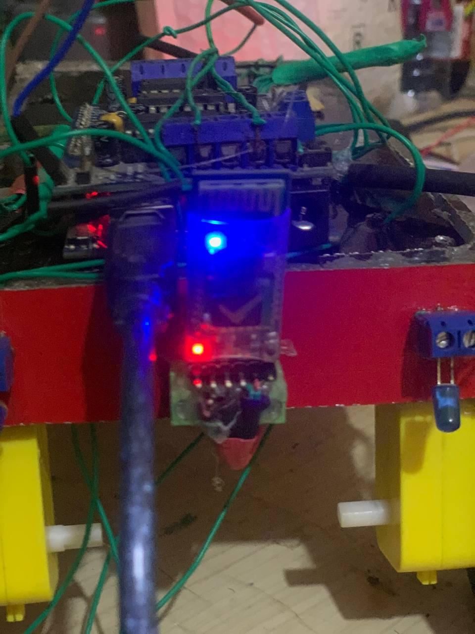

Step 4: Wiring Medibot – Connecting Components As Per the Schematics
In this step, we will connect all the components according to the provided wiring schematic. Here's how you’ll connect each component:
  1. Arduino Uno or Arduino Uno R4: The brain of the Medibot.
  2. Connect all wiring back to the appropriate pins on the Arduino.
  3. L293D Motor Driver Shield: Controls the DC motors.
  4. Connect the input pins of the L293D to the Arduino's digital pins.
  5. Connect the output pins to the DC motors.
  6. 4 DC Motors with Wheels: Enable movement of the Medibot.
  7. Connect each motor to the output pins of the L293D motor driver.
  8. Ultrasonic Sensor (HC-SR04): Used for obstacle detection.
  9. VCC to 5V on Arduino.
  10. GND to ground.
  11. Trigger pin to a digital pin on Arduino.
  12. Echo pin to a digital pin on Arduino.
  13. 2 IR Sensors (for Line Following): Help Medibot follow a line.
  14. VCC to 5V.
  15. GND to ground.
  16. Output pin of each sensor to digital pins on Arduino.
  17. Bluetooth Module (HC-05 or HC-06): For remote control.
  18. VCC to 5V.
  19. GND to ground.
  20. TX pin of Bluetooth to RX pin on Arduino.
  21. RX pin of Bluetooth to TX pin on Arduino.
  22. LEDs: For real-time status feedback.
  23. Connect the anode (longer leg) to the digital pins of Arduino through current-limiting resistors.
  24. Power Source (9V Battery or Rechargeable Li-ion Battery Pack): Powers the robot.
  25. Connect the power source to the Arduino and motor driver.
  26. Jumper Wires (Male-to-Male, Female-to-Male): For making connections between components.
  27. Breadboard: To organize connections.
  28. Switches (Optional): For manual control.
  29. Wire switches to the power supply or control pins on Arduino.
  30. Mounting Chassis for the Robot: To secure all components.
  31. MQ-7 Air Quality Sensor: For monitoring air quality (carbon monoxide).
  32. VCC to 5V.
  33. GND to ground.
  34. Output pin to an analog pin on the Arduino for reading CO levels.
  35. Flame Sensor: For detecting fire or heat.
  36. VCC to 5V.
  37. GND to ground.
  38. Output pin to a digital pin on Arduino for fire detection.
  39. DHT11: For temperature and humidity sensing.
  40. VCC to 5V.
  41. GND to ground.
  42. Data pin to a digital pin on Arduino.
  43. Sound Sensor: For detecting sound pollution levels.
  44. VCC to 5V.
  45. GND to ground.
  46. Output pin to an analog pin on Arduino to read sound levels.

Uploading Code to Arduino Uno R4 (IoT Part using Arduino IoT Cloud)
  1. Set Up Arduino IoT Cloud:
  2. Visit Arduino IoT Cloud.
  3. Sign in with your Arduino account (or create one if you don't have an account yet).
  4. Create a new Thing on the platform, which will represent your Medibot’s IoT functionality.
  5. Create Variables:
  6. In the Thing you've created, define the necessary cloud variables to control and monitor the sensors (e.g., temperature, humidity, sensor values, etc.).
  7. Insert the necessary variables here (e.g., temperaturepin, humiditypin, motion, etc.).
  8. Arduino IoT Cloud Code (ThingsProperty and Main Code):
  9. In the Arduino IoT Cloud, there are two main parts for coding:
  10. ThingsProperty Code: This part handles the configuration of your cloud variables.
  11. Main Code: This part defines how your device behaves based on the variables and communicates with the IoT Cloud.
  12. ThingsProperty Code: You will define your cloud variables in the ThingsProperty section of the Arduino IoT Cloud interface.

Upload the Code:
  1. Click on the Upload button in the Arduino IoT Cloud to upload the code to the Arduino Uno R4.
Test IoT Functionality:
  1. Power on Medibot and check if the cloud variables are updating correctly on the Arduino IoT Cloud dashboard.
  2. Test the cloud monitoring functionality using the IoT Cloud interface to see the sensor readings and other parameters in real-time.

Uploading Code to Arduino Uno for Movement Control (Bluetooth and Line Tracking)
  1. Prepare the Arduino IDE:
  2. Open the Arduino IDE and select Arduino Uno under Tools > Board.
  3. Select the correct port under Tools > Port.
  4. Insert the Code for Movement Control (Bluetooth and Line Tracking):
  5. This code will control the movement of Medibot, including:
  6. Line-following with IR sensors.
  7. Obstacle avoidance using ultrasonic sensors.
  8. Bluetooth control for remote operation.
  9. Insert the Movement control code here.
  10. Upload the Code:
Bluetooth
#include "AFMotor.h"
// Define motor pins
const int MOTOR_1 = 1;
const int MOTOR_2 = 2;
const int MOTOR_3 = 3;
const int MOTOR_4 = 4;
// Create motor objects for each motor
AF_DCMotor motor1(MOTOR_1, MOTOR12_64KHZ);
AF_DCMotor motor2(MOTOR_2, MOTOR12_64KHZ);
AF_DCMotor motor3(MOTOR_3, MOTOR12_64KHZ);
AF_DCMotor motor4(MOTOR_4, MOTOR12_64KHZ);
int state; // Variable to store received state from serial input
int Speed = 130; // Initial motor speed set to 130
void setup() {
// Set the initial motor speed for all motors (0-255 range)
motor1.setSpeed(Speed);
motor2.setSpeed(Speed);
motor3.setSpeed(Speed);
motor4.setSpeed(Speed);
// Begin serial communication at 9600 baud rate
Serial.begin(9600);
// Delay for half a second to stabilize
delay(500);
void loop() {
// Check if data is available to read from the serial
if(Serial.available() > 0) {
state = Serial.read(); // Read the data and store it in 'state' variable
// If the received value is greater than 10, set it as new motor speed
if(state > 10) {
Speed = state;
// Update the motor speed based on the received 'Speed' value
// Control the motors based on the 'state' value
if(state == 1) {
forword(); // Move forward when 'state' is 1
else if(state == 2) {
backword(); // Move backward when 'state' is 2
else if(state == 3) {
turnLeft(); // Turn left when 'state' is 3
else if(state == 4) {
turnRight(); // Turn right when 'state' is 4
else if(state == 5) {
Stop(); // Stop when 'state' is 5
// Short delay to avoid excessive serial reads
delay(80);
// Function to move all motors forward (for moving forward)
void forword() {
motor1.run(FORWARD); // Run motor 1 forward
motor2.run(FORWARD); // Run motor 2 forward
motor3.run(FORWARD); // Run motor 3 forward
motor4.run(FORWARD); // Run motor 4 forward
// Function to move all motors backward (for moving backward)
void backword() {
motor1.run(BACKWARD); // Run motor 1 backward
motor2.run(BACKWARD); // Run motor 2 backward
motor3.run(BACKWARD); // Run motor 3 backward
motor4.run(BACKWARD); // Run motor 4 backward
// Function to make a right turn by adjusting motor directions
void turnRight() {
// Function to make a left turn by adjusting motor directions
void turnLeft() {
// Function to stop all motors
void Stop() {
motor1.run(RELEASE); // Stop motor 1
motor2.run(RELEASE); // Stop motor 2
motor3.run(RELEASE); // Stop motor 3
motor4.run(RELEASE); // Stop motor 4
  1. Click on the Upload button to upload the code to the Arduino Uno that controls the movement.
  2. Test the Movement Features:
  3. Power Medibot and test if the movement features work as expected (line following, obstacle avoidance, and Bluetooth control).
