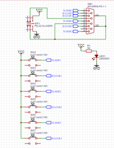

Here we will see the schematic diagram made in the easyeda software with all the electronic components and their respective values.

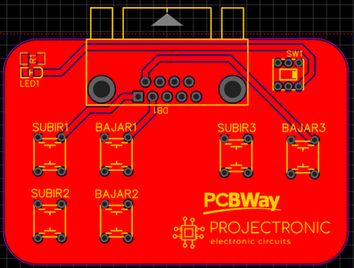

The circuit is fed with a VGA DB9 cable and there are also outputs to the rotation changes on the pcb there are 6 NO buttons to close the rotation changes. The pcb has an indication led that the project was powered correctly and a switch to activate the whole system

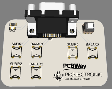

This project was made in the Easyeda software as we can see the tracks and the 3D image of the project working perfectly are no difficulty
