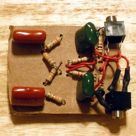

The second, third, and fourth images are of one of the initial synth implementations.
The initial design features two voltage-controlled pulse oscillators (VCOs) scaled at one volt per octave. MIDI control is done with a PIC microcontroller that receives data and outputs it to a digital to analog converter (DAC). The voltage from the DAC is used as a control voltage (CV) for the oscillators. Velocity has not been implemented in this version and the last note played is always heard at output.
