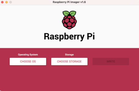

Step 2: Setup and Program the Raspberry Pi
You will need to flash an SD card with the Raspberry Pi Operating System. Go to raspberrypi.com/software/ using a laptop / PC and download the correct app for your system. Plug in a microSD card using the adapter. Choose "Raspberry Pi 32-bit OS" for the operating system and your microSD for the Storage. Once it installs, set up the Pi using the MicroSD card.
Connect to a valid Wi-Fi network. Open the terminal app and type the following commands:
sudo pip3 install python-rtmidi
sudo pip3 install adafruit-circuitpython-mcp4728
Next, open Thonny. The code is at github.com/abhay-harpalani/analog_synthesizer/tree/main. It uses the rtmidi python library and the Adafruit DAC to convert the digital MIDI signals into an analog voltage. Download this code and paste it in a file in Thonny.
