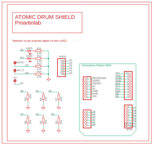

Step 2: Schematic and PCB Assembly
The schematic indicates how to put resistors and components. I used Eagle which has labels to indicate connections easily, so in case you are not familiar with that, an example: A0 is connected with a wire (green color) to a resistor, but also is the name of a point in the Arduino, so all of them are connected togehter, and same thing as the rest of the labels.
I suggest you to use this shield-shaped prototype boards (like the one in the picture), it´s way more solid than using a protoboard.
You can see in the pictures how it looks like in the prototype and the final version of the board.
