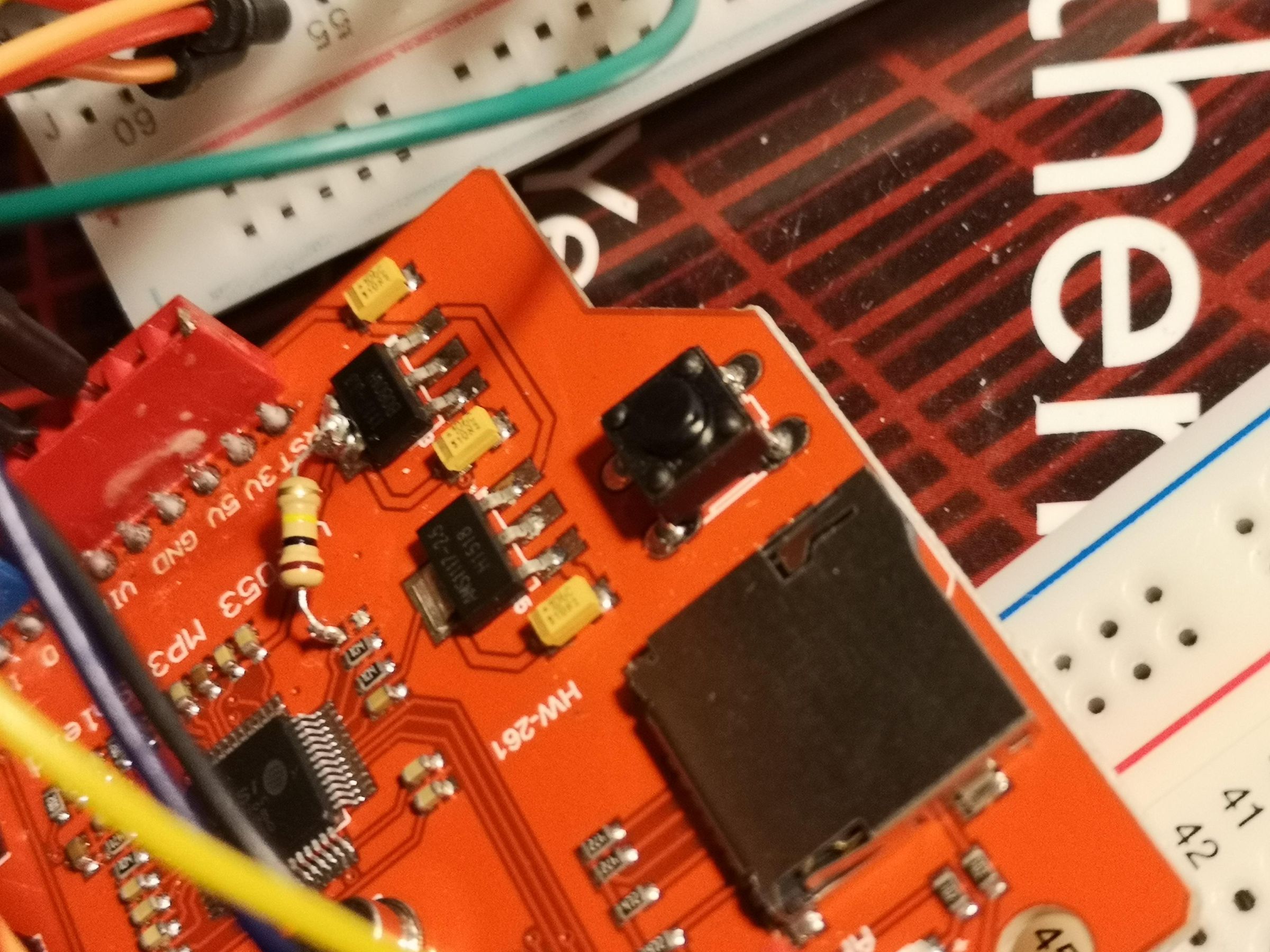

Step 1: Controlling the VS1053

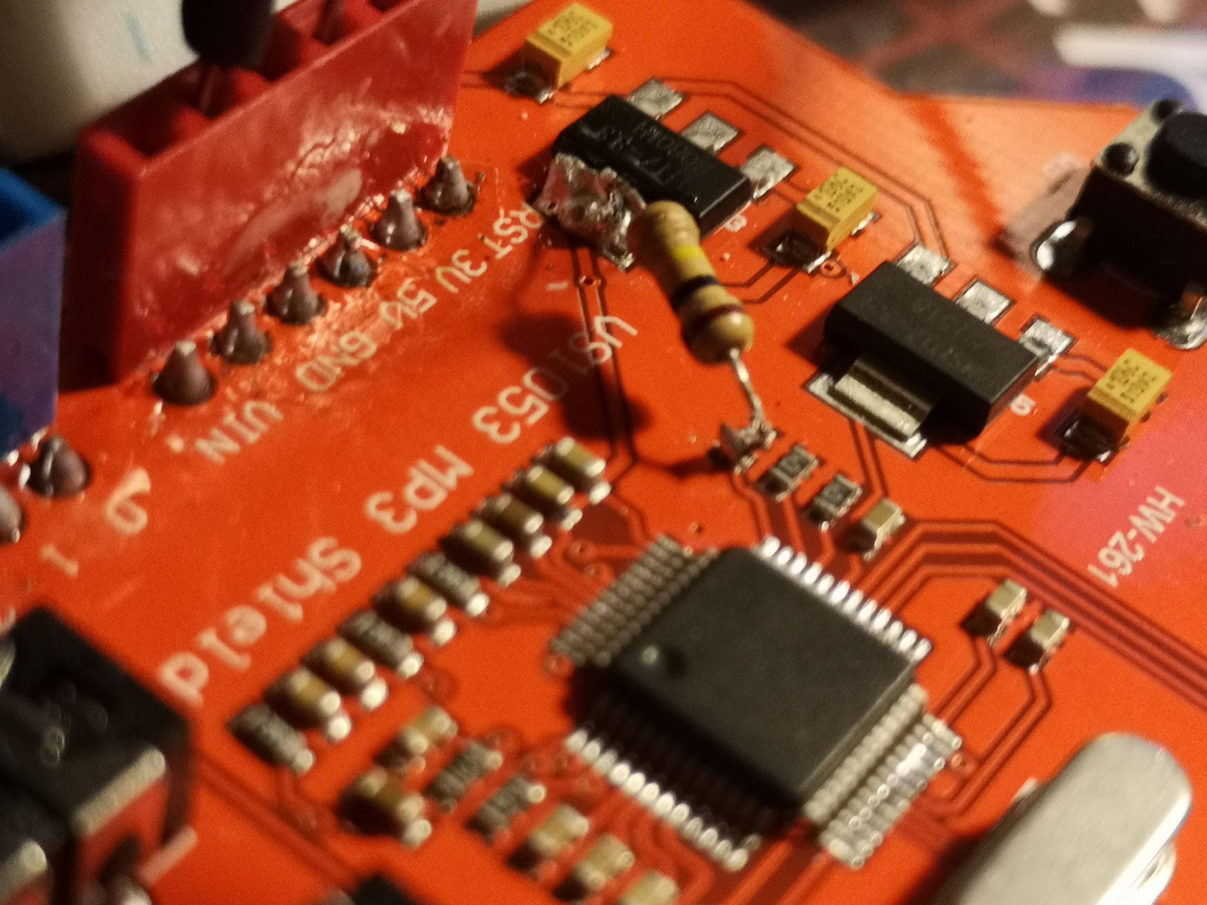

I chose the VS1053 module shown in the picture. (Note the two SOT223 regulators, the two jack sockets and the position of the connector.) Search eBay, Alibaba or your favourite supplier for a VS1053 module that looks like that. They are available from Aliexpress here and here.
I bought it a couple of years ago and it no longer appears to be available on eBay, only on Alibaba. A red PCB version is now available on eBay. It appears to be functionally identical but the pinout is different so you'll need to adjust my schematics and layouts. I haven't tested it. In the discussion (below) you can find instructions on how to add a resistor to the red PCB to enable "live" MIDI. Or you can send additional commands during setup to enable it.
The VS1053 is a fine chip but rather complicated. I'm only using the MIDI part of it. It's possible to control the VS1053 over a serial interface but I'm using the SPI bus as it's more convenient with an Arduino Nano. Any byte you send over the SPI bus is treated as a MIDI command.
You'll find lists of MIDI commands on the web. The VS1053 responds to some but not all of them. The Miditheremin0.exe program shows the ones that I know work.
You can download the VS1053 data sheet from the web. It's a huge document and is hard going. Section "8.9 Supported MIDI Formats" is almost all it says about MIDI. Section "10.10 Real-Time MIDI" talks about using GPIO0 and GPIO1 to enable MIDI but the board I have didn't require any special enabling. You can also download a list of MIDI messages (not all of which are supported by the VS1053).
Wire the VS1053 module to an Arduino Nano as shown and upload the INO file to the Arduino. I used a solderless-breadboard. I don't have a photo of it at this stage but you can see the breadboard with other components in a step below.
The INO sketch receives a byte from the PC over the serial line and sends the byte to the VS1053. It's a very simple program which allows you to test the VS1053. Connect the output jack socket to headphones or a computer speaker.
The Windows Miditheremin0.exe program (download Step1.zip from github) sends commands to the VS1053. Click the "90 note vel" button to play a note. Or you could write your own Windows program. Or use one of the many terminal programs available on the web.
The VS1053 module has the following pins:
  • the SPI bus has the usual MISO, MOSI and SCLK
  • if XRST is low, the chip resets
  • XDCS doesn't do anything in SPI mode so tie it to XCS
  • XCS is Chip Select
  • DREQ tells you when the chip is ready for a new command.
XCS should be set low while you're sending a byte; then high. That way, you're sure you have synchronised the first bit of each byte. Reading DREQ tells you that the chip is ready to receive a new command.
After the Arduino sends a byte, it must send a dummy byte so as to toggle the clock and allow the VS1053 to send a byte back in response. The SPItransfer() function shows you how.
The red module available on eBay includes an SD card slot so it has a couple of extra pins. Ignore them.

First of all, I want to thank Peter Balch for the fantastic project. Finally my red VS1053 card arrived and I made the modification explained by Mr. Mike Rainbow and it worked, the theremin worked. The new vs1053 boards, both the blue board (my blue board has spoiled from trying so hard to make it work) and the red board does not come from the factory released for MIDI. You have to release this function by software or as I did following Mike Rainbow's explanation. Removing the resistor and soldering another 100k to the 3v voltage regulator heatsink. Only that solves it. The new blue module ... I couldn't release it. I advise using red with the change made. https://www.youtube.com/watch?v=7xIEA66e7eI&t=493s
0
oscarellis24
oscarellis24
Reply 6 months ago
thanks so much for the tip. Will it work with the red board for an UNO as well (i accidentally bought that board). And where do you think i could find software to unlock it?
0
WesleyC57
WesleyC57
Reply 6 months ago
https://github.com/diyelectromusic/sdemp/tree/mast...
I found this one but didn't test it within Mr. Peter Balch's code. I know it works because I loaded it on a nano arduino with the standard connections of the vs1053 board and the midi worked without changing the board. I preferred to change the hardware because as I don't know how to program, for me it was much easier and it also worked perfectly.
0
diyelectromusic
diyelectromusic
Reply 4 months ago

WesleyC57
WesleyC57
Reply 6 months ago
Hi Peter,
I just tested the midi enabling code on this github link, and it worked perfectly. In the code there is a plugin provided by the manufacturer that enables midi in real time without having to solder the resistor on the board.
As I don't know how to program lol I haven't tested it in your code. I preferred the radical method hahahaha. The only things I changed in your code to customize here in the theremin I built were the colors and a second button that comes out of the menu and saves the changes.
The green board did not find information about it on the network, I will search further to get to know it.
Sorry my bad english haha
Thanks,
Wesley
WesleyC57
WesleyC57
Tip 6 months ago
I made a photo with captions to make it easier to see the change in the red vs1053 card. For some reason I am unaware of some ST7735 displays that I purchased and even used in other projects, the image was distorted. If you buy one of these strange displays, I was able to solve the problem by increasing the default value of the resistors from 1k to 1k2 and adding a resistor of 1k2 on the reset pin of the display and a 33R on the LED pin ... well ... I made a tests and normalized :-)
0
oscarellis24
oscarellis24
Reply 6 months ago
It is not my best soldering job but it should do the trick. However the program included still doesnt not seem to activate any noise into my headphones, apart from a high pitched buzzing sometimes, then it stops if i reload the com port
0
WesleyC57
WesleyC57
Reply 6 months ago
C
0
oscarellis24
oscarellis24
Reply 6 months ago
I have done the new soldering and i think it is still not working. Again i only see a flashing light on RX when vel 90 is clicked. I am a bit defeated now because i wont get the new board until after christmas, even when i was hoping i could use this as a present. I can only assume it is the board as i am pretty sure everything else is correct.
0
oscarellis24
oscarellis24
Reply 6 months ago
This is so useful thanks a million!
0
oscarellis24
oscarellis24
Reply 6 months ago
amazing
