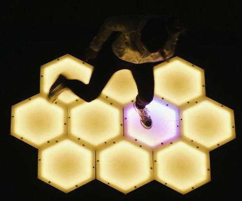

In this instructable we'll show you how to make a light and sound interface that can be used to play "Simon Says" and as a MIDI interface. Both modes will be played with your feet.
Background
The project was born because we wanted to make an interactive installation where almost any kind of audience could make use of it no matter their age. It was developed for a mall, as one of its attractions.
The first reference that we got from the client was this version of Simon Says that could be played with people's feet. We basically had to replicate this idea.
We researched similar game/platforms, and we found a lot of dance floors, most of them work with light but not sound. We also found big pianos for feet so we thought that something interesting could come out from adding the musical instrument functionality. For the love of music!
We also considered the shape of the platform. Almost every dance floor that we found were rectangular, with square pads. There is one exception that has circular pads. We wanted to give a different feeling to our platform while keeping the modular aspect of squares, that's why we decided to use hexagons.
While searching for projects with hexagonal shapes, we found this one. The idea of making hexagonal shapes was exciting to us... we didn't had an idea of what was coming.
We had a clearer goal:
- Simon Says game
- Musical instrument
- Hexagonal pads

We decided to use metallic profiles because of the strength, low cost and availability of the material.
The structure consist of two hexagons joined by six short poles:
For each hexagon we cut 12 pieces of metal with a grinder same for the poles and then we welded everything.
The space that's left between the two hexagons, helps to protect from water or anything that can cause damage to the electronics and also for routing the cables.

We chose an industrial mechanical switch to activate the pads. Due to the flexibility of the acrylique and since the switch is placed in the center of the hexagon through the pvc sheet, the amount of pressure that the switch needs to be activated can be achieved when the user steps on the acrylique surface. We calibrated how high or low the switches needed to be with washers.
