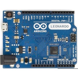

Arduino Leonardo

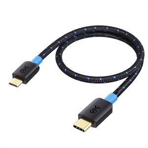

Micro USB cable

The Arduino Leonardo is a microcontroller board based on the ATmega32u4. Unlike many other Arduino boards, it has built-in USB communication, allowing it to appear to a computer as a keyboard, mouse, or MIDI device without extra hardware. It features 20 digital I/O pins, 12 analog inputs, PWM outputs, a 16 MHz clock, and can be powered via USB or an external supply.

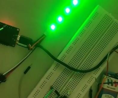

Step 5: Testing
Now connect your midi theremin to your computer using the micro usb port of the leonardo . Open any DAW software and play
