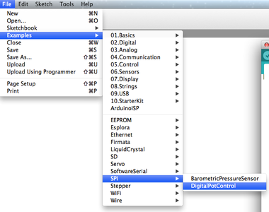

Step 1: Getting Started With SPI and Digital Potentiometer
If you are feeling ambitious or are fairly well experienced with electronics, you may be able to skip this step.
Check out the Arduino Digital pot tutorial and use the example code provided with the program.
http://arduino.cc/en/Tutorial/SPIDigitalPot

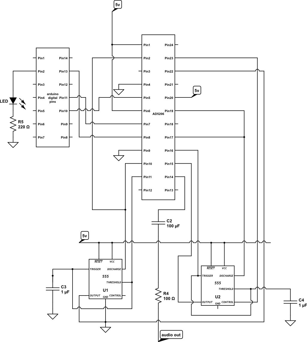

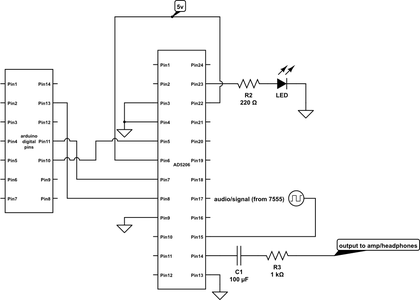

See the schematic here:
https://www.circuitlab.com/circuit/9c989j/digipot-basics/
The astable oscillator is omitted from the schematic to try to keep things simple on the page.
Step 2: Testing the Basic Circuit
If you are well experience with Arduino and basic electronics you may want to skip ahead.
With the circuit built, run the SPI digital potentiometer in your Arduino IDE.
When wired correctly the LED and volume of the audio signal should jump to they maximum and then fade out repeatedly.
