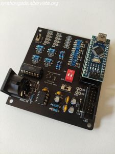

Step 1: Hardware and Features
Main features of this hardware are:
    - built-in MIDI input circuit
    - up to four, op-amp buffered control voltage outputs (DAC outputs)
    - up to four, passively overvoltage/inverse voltage protected PWM pins
    - up to two additional digital I/O pins (unprotected)
    - built-in 2 poles DIP switch for setup settings
    - built-in 1 pole switch for other settings
    - dual power supply input (+/-12V) protected against inverse polarity

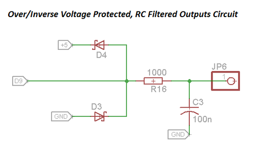

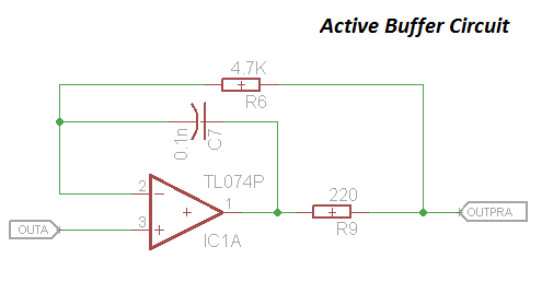

    Quad DAC outputs are overcurrent and overvoltage protected by a dedicated buffer IC, with one amplifier for each CV channel (see attached schematic). For the first time I adopted an active overcurrent protection for DAC outs in place of the simple current limiting resistor most often seen in DIY projects. This not only because it works better, but also because being the MCP4728 a surface mount device that will ask for some extra effort to solder in place with a common soldering iron, we don't want it to die because of an incorrect patching!
    Gate outs are wired to Arduino's PWM pins. This way we can use them to deliver digital, on/off signals like gates signals, or use them to deliver control voltages by toying with Arduino PWM capabilities. Gate outs are inverse voltage and passively over voltage protected by zener diodes (see attached schematic), but I also placed a RC filter downstream for such PWM-to-CV possible applications.
    MIDI input (schematic attached)is the classical arduino circuit based on 6N138. To reduce CPU load, I prefer to use the hardware serial to upload sketches when possibile in my projects. A dedicated hardware switch unhook arduino's receiving pin (Rx) from the MIDI circuit and makes loading a new sketch possible.
    Components values are silkscreened directly on the PCB because it's way easier to assemble a PCB this way instead of having a comparison sheet.
    As a reference, hardwired arduino's pins are:

    Step 2: PCB and BOM, Faceplate Notes

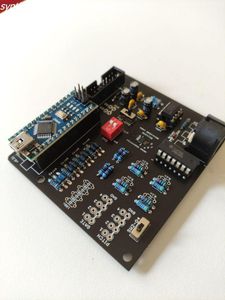

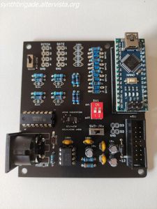

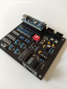

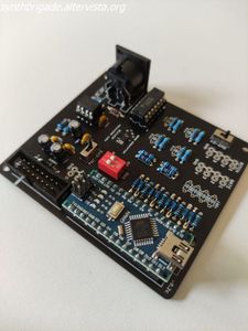

    The project is made up of two boards: main PCB and faceplate.
    Main PCB
    All components values are silkscreened on the PCB to make assembly easier.
    The board is intended to be mounted on the bottom of the case with the MIDI connector facing out, and with used outputs connected to the faceplate through wires.

    Step 4: Soldering Tips
    Being the DAC a 0.65 mm pitch integrated circuit, you have to adopt some strategy to succesfully solder it in place with a common stilus soldering station. My suggestions are:
    - solder the DAC first. You will need space around your solder tip and you don't want to waste other components in case of problems.
    - use a thin iron to solder the chip and a scanning electron microscope (just kidding! A magnifying glass will suffice)
    - use some soldering flux. I had the best results with a cheap "no-clean" Rosing Mildly Activated (RMA) pen
    Soldering Method:
    - melt a little amount of solder on the IC pads on the PCB. You want to see a certain amount of solder over the pads, but no shorts between pads
    - place the DAC over it (with the right orientation!) and wet everything with the soldering flux
    - remelt the pad-solder with a clean iron tip while applying a veeeeery small pressure on top of the IC.
    Re-apply the flux everytime you feel it's needed.
    The iron temperature is very important: it should be high enought to fast melt the solder, but not too high or it will kill the IC. I had success with a temperature of 350-370°C.
    When the DAC is soldered, check for continuity between IC's legs and the corresponding vias, close to each feet of the IC.
    This is the method that works best for me. Again: keep attention to the IC orientation!
    Having it well soldered could ask for some trial and error at first, but believe me: if I can do that, you can. As a precaution buy more than one IC.
