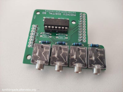

Digital Board
4x PJ324M (stereo or mono) female jack socket
1x TL074 operational amplifier
4x 1000 ohm resistors
8x 10K ohm resistors
1x 8-pin female header
1x 11-pin female header
1x 8-pin male header
1x 11-pin male header

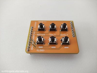

Calibration Pad
4x tact switches

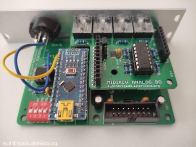

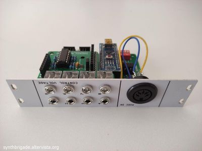

Step 1: Hardware Configurations
As anticipated, the project is made up of three (plus one) boards:
  1. Main board
  2. Analog board
  3. Digital board
  4. (Calibration pad)
A modular module is not such without a front panel, so I also layed down a dedicated one :)

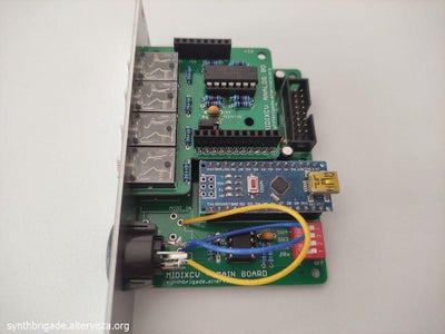

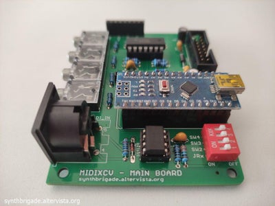

Main Board
Main board is the hearth of the project. It hosts the microcontroller board (Arduino NANO 328p), the MIDI input circuitry, a power supply filter section, a digital to analog convertion stage and a final amplification and protection stage.
The main board is stand alone, which means that if your project calls for 4 analog voltages, you need no more than that.
A DIN-5 MIDI connector can be directly soldered to the main board PCB, but this will make the module front panel not compatible with the PCB's stack. I use MIDIXCV this way, securely anchored to the bottom of my DIY case (there's some free space in the bottom). Alternatively you can adopt the Eurorack compliant front panel I layed down, but please notice that a different MIDI connector must be used (see attached pictures).

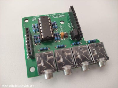

Analog Board
An analog voltage is a voltage that can assume any value in a given voltage range (e.g. 0 to 5V). Analog boards (please notice the plural) are intended to increase the number of analog output stages.

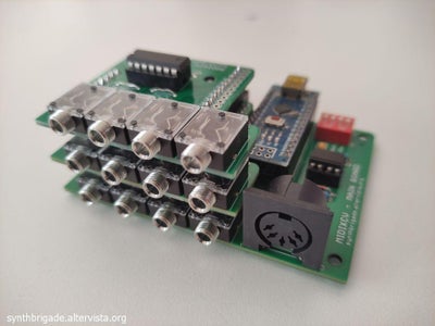

Every analog board adds "four" control voltages to the total outputs count.
Analog boards cannot work by themselves but are intended to be stacked over the main board. The more analog outputs the user needs, the more analog boards will stack.
In example, if 8 analog voltages are what you need, main board and a single analog board will be assembled and stacked toghether. For 12 outs you want to stack two analog boards over the main board.
In principle, one could stack up to 7 additional analog boards over the main board, thus gathering a total of thitry two analog voltages (*).
(*) The use of more than 12 outs is untested. Eight outs (main board + one analog board) is actually the configuration I tested the most.

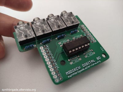

Digital board
Digital signals are used to transfer binary messages. The two voltage values commonly representing the two states are 0V and 5V, but in modular synths world this can extend up to 12v.
This being said, a digital board was not really necessary being that analog voltages can be used (up to some extent) to control digital signals. Being that a digital board could be easily layed down and that analog board is more difficult to assemble (MCP4728 is a very small SMD device) and expensive (again, because of the DAC), I ended spending a due amount of time on this too.
Digital board delivers a maximum of four indipendent digital outputs. Stacking more than one digital board to the main board will lead to an active multiple, but you will still have access to no more than four indipendent outs.

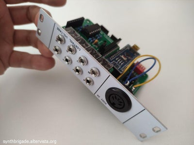

Front Panel
This very specific front panel has been layed down to handle main board and a single additional board for a total of eight individual outputs.
Stacks of more than one additional boards are not compatible with the current front panel, but it would be possible to design new panels.
The panel exposes eight outputs and the MIDI IN connector to the user.
Disclaimer: MIDIXCV hardware can output voltages up to 10V. Feeding a voltage higher than the maximum rating of the destination hardware can damage it. I cannot be held responsible for any use, proper or improper, of MIDIXCV or any information reported.

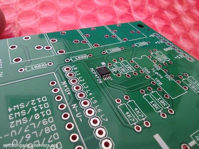

Step 2: Hardware Description
Most of the circuits I adopted for this project are well known and similar to those used in my previous MIDI4CV project.
Hardwarewise, main implementations are the stackable nature of boards (which makes the whole device way more flexible), the output voltage extention to the 0 - 8V range and the adoption of a different final protection stage.
The use of Arduino's PWM outs in conjunction with (cheap and easy to assemble) RC filters I adopted in some previous projects of mine has been completely discarded because highly unstable (you would need at least a PWM frequency of 1KHz for decent results and Arduino NANO has less than half that frequency).
MIDI IN Circuit
The MIDI input circuit is the most basic design built arount a 6N138 optocoupler. I have adopted this a ton of times in my projects and works great.
The circuit is compliant with MIDI Association specifications.
Microcontroller Board
Incoming digital messages from MIDI IN circuit must be converted into analog voltages in order to speak the same language of your synths modules.
MIDIXCV brain is an Arduino NANO328 microcontroller board. It receives MIDI messages and converts them to (still digital) user definable informations. These are then sent to DACs through I2C comunication protocol.

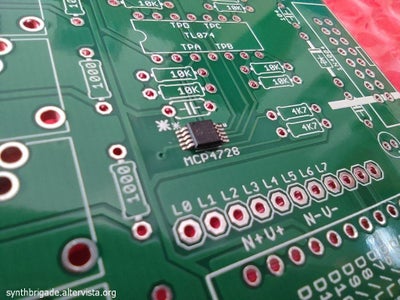

Digital to Analog Convertion
The digital to analog circuitry is a MCP4728 12-bit QUAD DAC and it's slave components. DAC's resolution is approximately 1mV (with internal voltage reference), reduced to 2mV at the final amplification stage.
This is a very good hardware choice for this application, but also the existence of a whole lot of different libraries for it is very important and drammatically increase the chances of success of a hobbyist (do not forget) project like this.
Amplification and Protection Stage
Every single DAC output (main board, analog board and digital board) is buffered and over/inverse voltage protected by op-amps (TL074), followed by series resistors.
There are debates on which is the best solution for this task, but honestly I find the aforementioned one's simplicity a winner with respect to the (small) voltage loss it cause (*). A good calibration (see dedicated Step) takes care of the voltage loss anyway.
Op-amps amplification is hardware set to 2X. User can limit the output voltage by software. In example, if a CV is intended to drive pitch, the full voltage range should be used. On the other side, if control voltages for modulation sources or gates are going to be outputted, they should be limited to 5V. It is very important to collect informations about the modules you are going to control with MIDIXCV output voltages in order to understand the limits.
(*) Well designed modules have high impedence at their CV inputs. Assuming 5uA of current absorbed during normal operation, a 1K ohm series resitor will cause a 5mV voltage drop.
Others
Main board and slave boards are put into electrical contact by means of pinheaders. Pinheaders have the additional benefit of giveing some structural "stability" to the whole module.
There are four DIP switches on the main board. One is hard wired to arduino's Rx line and must be used to upload a new firmware (more on this later). The other three are directly connected to three arduino's digital pins and can be used for general tasks like activating functions and modes coded into the sketch.
Female jacks are PJ324M stereo. The stereo feature is not used, but these are easier to source and anyway compatible with the mono version, then a good choice for me.
The PCB mount MIDI DIN (5-DIN) used is very common too. The one selected for face panel mount makes no exception.

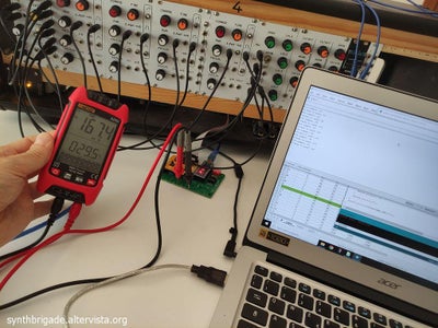

Step 4: Analog Out Calibration Sketch
Even if ideal voltages for pitch control are simple to derive, real world physics makes things more complicated.
In addition to this, being that there are no two electronic components acting exactly the same, a calibration process is mandatory.
Calibration here reside in the fine tuning of all single output voltages. In the main sketch these are associated to numbers from zero to 4095 (the 12-bit thing, remember?). The goal of this procedure is to find the number giving the best real vs ideal voltage match possible for every single semitone in the whole octaves range supported (eight).
Calibration calls for a good, calibrated, voltmeter and a PC with Arduino IDE installed. Results are real-time displayed on the serial monitor.
The sketch handles 4 indipendend outputs with a CV table each: this means that you are going to set 96 x 4 values (yes, it's a whole lot of work).
Calibration procedure
Upload the calibration sketch (MIDIXCV_outs_calibration.ino) to MIDIXCV and open arduino IDE's serial monitor. Place your voltmeter leads to ground and to the analog output you want to calibrate, then:
1 - short to ground "N+" (note# +) or "N-" (note# -) pad on the main board to increase or decrease the MIDI note# you want to tune
2 - short to ground "V+" (voltage +) or "V-" (voltage -) pad on the main board to increase or decrease one step (*) the voltage of the current MIDI note#
3 - when all notes have been calibrated, press "N-" (note# -) while keeping "N+" (note# +) pressed: a full log will be displayed.
4 - Copy and paste the log in MIDIXCV.ino sketch replacing values in cv#ExtRef[MAX_EXT_V] array.
5 - repeat for all four outputs
6 - Upload MIDIXCV.ino sketch with the four updated arrays: MIDIXCV is now calibrated!
(*) Steps are approximately 2mV steps.

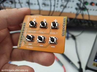

Calibration should be done with a load applied: your VCO's "V/oct" input is a very good choice or, eventually, a 100K ohm resistor to ground will do (e.g. the load value on my AS3340 VCO module is 90K ohms).
Being the calibration procedure a tedious one, I layed down a simple calibration pad PCB (*) to make things simpler. It is not mandatory to use it, but helps A LOT.
(*) Please notice that the shared calibration pad has "reversed" layout and silk-screened prints with respect to the one pictured in this instructable. I think it is more practical now ;)
By default the calibration sketch is set to tune outputs of the device with ID#0, but it can be easily modified for any of the other possible devices (ID# 1 to 7). See next step on how to set up analog boards and their IDs.
Step 5: Analog Boards - How to Set Up
In order to give DACs their own identity thus simplifying the MPU communication task, it is necessary to reprogram them with a unique address each.
As always, the Arduino Community comes to the rescue and makes operations like this possible also for non professionals like me and you.
I slightly modified a reprogramming sketch from Jan Knipper in order to simplify things a bit. Follow thse steps:
1) Install SoftI2CMaster library in our arduino IDE
2) Open the reprogramming sketch (MIDIXCV_DAC_address_prog.ino)
3) Change #NEW_ADDRESS global constant to your desire (if you have a single analog board, set it to "1", otherwise use individual values for each analog board)
4) stack the analog board you are going to re-address over the main board
5) short pin "LX" and "L1" together with a removable jumper
6) Upload the sketch
7) put the jumper back to short "LX" and "L0".
You can now test how many unique-address chips are installed by running I2C_Scanner. Open the IDE's serial monitor: If everything went well unique DAC's addresses will be displayed for each DAC.
Step 6: Soldering Hints
Being the DAC a 0.65 mm pitch integrated circuit, you have to adopt some strategy to succesfully solder it in place with a common stilus soldering station. Some suggestion follow.
General Procedure:
solder the DAC first. You want space around your solder tip and you don't want to waste other components in the case of problems.
- use a thin iron to solder the chip
- use a magnifing glass to zoom the soldering area (even better would be one of those "cheap" microscopes they sell nowadays, but it's not everybody priority I know)
- use soldering flux. I had the best results with those siringes containing dense flux, lately.
Soldering Method:
- melt a little amount of solder on PCB's IC pads. You want to see a certain amount of solder over the pads, but no shorts between pads
- place the DAC over it and apply soldering flux. Be 100% sure the IC has the right orientation!!
- remelt the pad-solder with a clean iron tip while applying a very small pressure on top of the IC.
Re-apply the flux everytime you feel it's needed.
The iron temperature is very important: it should be high enought to fast melt the solder, but not too high or it will kill the IC. I had success with a temperature of 350-370°C.
When the DAC is soldered, check for continuity between IC's legs and the corresponding test point, marked TPA, TPB, TPC and TPD.
