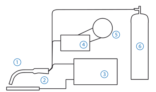

COMPONENTS
The figure shows the basic components in the MIG welding system.
1. The welding torch/gun
2. The workpiece or base metal
3. The electrical power supply
4. The feed unit
5. The electrode (filler metal) source
6. The inert shielding gas source

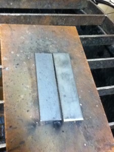

Step 6: Square Joint (set Up)
A square joint consists of welding two pieces of metal end to end, as shown below. The two pieces must be parallel and the top surfaces flat. This weld can be used in many different applications.
NOTE: Thicker materials may require a groove to be cut in the seam in order to ensure the weld penetrates the material entirely.

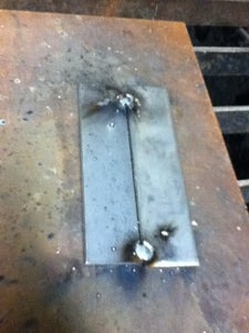

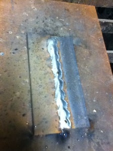

Step 7: Square Joint (tack Welds)
Notice at the beginning of the video in the next page that there are two small "tack" welds made. This is to ensure that the two workpieces stay a consistent distance apart while welding. Otherwise,when the weld bead is started, the metal will deform due to the thermal expansion and contraction. After the tack welds are placed, the seam weld is laid down as shown in the following video.
Step 8: Square Joint (weld)

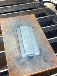

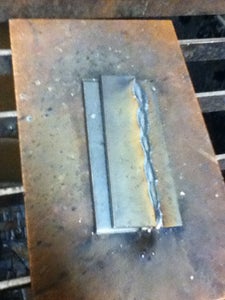

Step 9: Lap Joint (set Up)
Step 10: Lap Joint (weld)

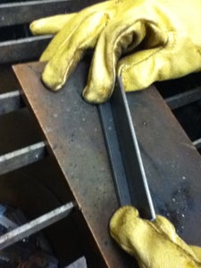

Step 11: Tee Joint (set Up)
A tee joint is similar to a lap joint, in that they both consist of welding two perpendicular faces. The differences is that a lap joint has two workpieces oriented in the same plane, while the tee joint has one piece perpendicular to the other. This is also a fillet weld.
The setup may require more extensive fixturing than the last two joints, especially if the workpiece does not stand up on its own. Fixturing is also important in tee joints due to the thermal expansion and contraction of the metal. As the metal solidifies, it will contract and pull the upright piece down to make a smaller angle with the horizontal piece. This can be prevented by fixturing the pieces, with something like a clasp, to prevent the pieces from moving.
Step 12: Tee Joint (weld)
