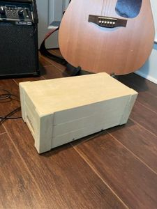

This is a small amplified instrument with which you can easily add percussion to any sing song or impromptu gathering of musicians. It fits easily on a one’s lap and played through a guitar amp has surprising tonal quality. I learned what not to do by building a prototype which can be found here: https://www.instructables.com/ELECTRONIC-LAPTOP-CAJON/

 I built this second iteration hoping to solve all those problems, using Baltic birch plywood which is solid, has good resonance, and has no interior voids.

Build the box. Mine is 12” L, 6” W AND 5” D. Use 5mm for the sides and 3mm for the top. Take your time and use glue only. Simple lap joinery is the strongest and best. Cut a piece of the MDF to fit snugly inside the box as a bottom. This gives it weight and is a stable surface for the electronics. Play the box like a drum to see if it has proper resonance. Mine did, but you may have to glue some sticks of wood to the inside top to get the right sound. Also, drilling a hole in each side will greatly add to the sound quality. Also drill small holes near the bottom to attach the MDF base. To be whimsical, I made the box look like an upside down crate, and sprayed it with 3 coats of clear lacquer to make it more durable. A diagram is provided.

Before attaching the box, plug in the cord, connect to your amplifier and do a test. Tap each transducer and you should hear a tap sound. Try the volume control. If it works in reverse, change the outside potentiometer connections.
If it all works, carefully attach the box with wood screws and start drumming. Experiment with the volume. You’ll be surprised at the effects, slapping various places on the top, as well as the front and sides gives varying tonal qualities. If accompanying someone on a guitar using the same amp, I suggest using a mixer.
