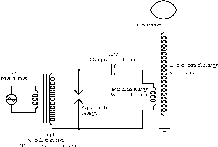

How it works: First off the mains goes through a high voltage transformer and charges the capacitor bank. When the caps are done charging they will let the high voltage from the transformer "pass" through them. During that split second (much to fast for a human to detect) the arc will jump through the spark gap, which is automated with RSGTC's, the caps will discharge into the primary coil. This is where resonance comes in, the fast action of the caps and spark gap rapidly induces an electromagnetic field around the primary, what many dont know is it starts off as a low voltage that adds up each time the spark gap fires until it creates extra high voltage

Step 5: Wire It All Up
Connect the HV transformer to the AC mains, connect the spark gap in parallel with the HV output, after that connect the capacitor bank series and close it off with the primary coil. Put the secondary coil inside the primary and hook the bottom wire to ground (I did nothing with it) and add a topload/toroid/torus to increase the voltage and effects of the sparks.
