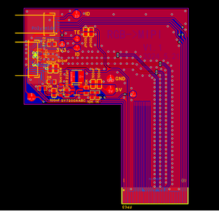

Introduction: MIPI Screen FPC Adapter
This tutorial explains how to use FPC (Flexible Printed Circuit) to create an adapter board for driving MIPI screens. We will show how to connect the MIPI signal from an existing development board using this adapter while maintaining the original screen's backlight drive.
Supported Screens
The adapter board in this tutorial is currently compatible with the 5.0-inch XH8379A MIPI screen, and it also supports the NT35516 screen, as they have identical definitions and interfaces. The touch controller used is the FT5436.
Step 1: Background Information
The D133 supports RGB, LVDS, and MIPI interfaces, which is why we designed an adapter board to extract the MIPI signal from the original development board’s RGB interface and connect it to the mobile screen interface. The backlight drive uses the original RGB screen's backlight circuitry.
Step 2: Key Considerations
Backlight Drive Current Check
When using the adapter board, it is crucial to ensure that the backlight drive current meets the requirements. If the current is too high, it may damage the backlight or even the drive circuitry. Therefore, special attention should be paid to the stability of the backlight current when making connections.
FPC Connection Method
We use FPC to connect the screen, eliminating the hassle of external ribbon cables and connectors. The FPC connection is flexible, making it suitable for applications where space is tight or custom shapes are needed. Additionally, if more strength is required, reinforcements can be added to key areas of the FPC.
Step 3: FPC Production and Procurement
The FPC for this adapter board is made by JLCPCB, a company that provides high-quality custom electronic products suitable for mass production. You can customize the FPC through JLCPCB based on your specific requirements, choosing the appropriate specifications, thickness, and connection methods.
Step 4: Summary
This MIPI screen FPC adapter board can convert the MIPI signal from the development board’s RGB interface to the mobile screen interface, while maintaining the stability of the backlight drive. Using an FPC connection not only simplifies hardware design but also provides flexibility to accommodate various sizes and shapes. During production, make sure to check the backlight drive current to avoid damaging the backlight and drive circuitry.
By using JLCPCB to produce the FPC adapter board, you can easily complete various screen connection designs and integrate them into your projects.
