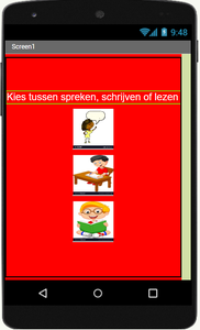

1.First, the home screen: you start with 3 options, speak, write or read. I used icons to make it clear for the children to.
