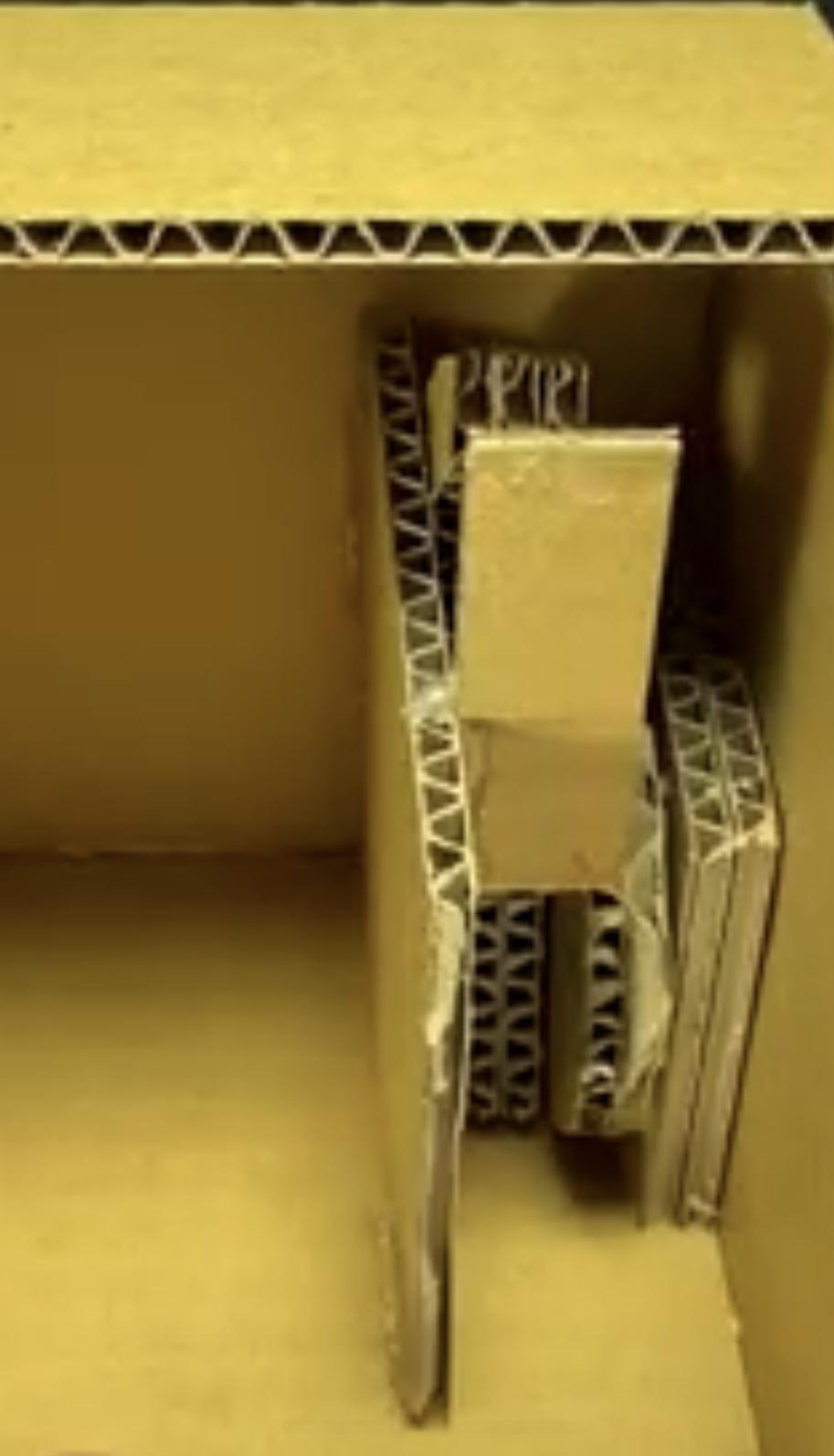

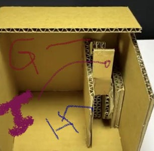

9. Glue the three pieces of grabber. Put
a hole at the bottom center and thru
all three. Place the grabber onto the
chopstick which is glued at the edge
of part “F”. DO NOT GET ANY GLUE
ON THE GRABBER.
Make sure the grabber Part “G”
rotates freely and loosely on the
chopstick. Step 8.0
10. Place part “H” (10cm x 10cm) to the
left of the grabber, Part “G”. Glue in
place. Let dry. This piece will hold
the grabber onto the chopsticks
and prevent the grabber from falling
off. Step 9.
11. Place and glue Part “I” onto “H” as a
stop for the forward motion of the
grabber, Part “G”. Step 10.
12. Place and glue Part “J” on the top of
the box.

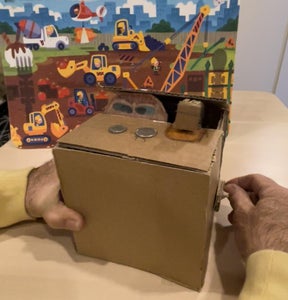

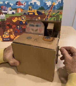

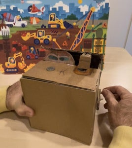

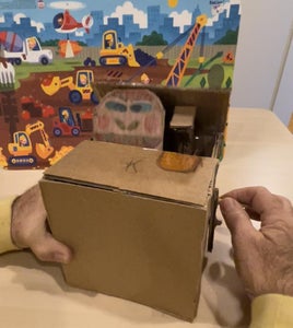

At this point rotate the handle and
observe the grabber push up the
loose lid and return to its hidden
position. Step 11.

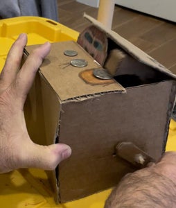

15. Check for a working grabber by
rotating the handle. Adjust taper of
grabber if needed. Step 14.
16. Close off the box by glueing the
front Part “L” onto the box. Step 15.
ON THE GRABBER.
chopstick. Step 8.0
off. Step 9.
the box.
position. Step 11.
