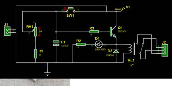

Step 1: SCHEMATIC DIAGRAM
Here we will see the schematic diagram of the project and all its values ​​to be able to do it both on the breadboard or on the pcb
Step 2: FUNCTIONING
Many times we have a hard time making circuits without the data sheet of a main component. This is the case of a 555, we know that with this device we can carry out many applications, pulse generators, delay generators, etc. But what would happen if I wanted to make a disconnection time delay circuit with a single pulse? Let's put ourselves in the case that one day we don't have this integrated. Well, in this video we will learn how to make the turn-off time circuit with a single pulse, just with a few resistors and a capacitor without using the 555 or another similar component, in addition, we will be able to regulate the duration of the turn-on time after having pressed a button.
