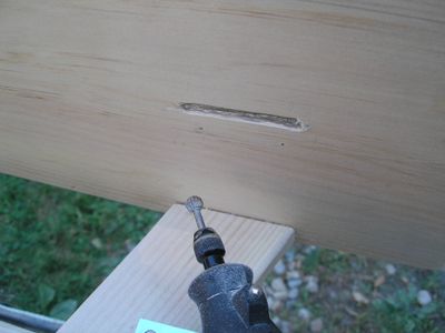

To make hinges lay flat I ground holes in the inner stand legs for the hinge part of the hinges to set in to.
I screwed the hinges to the rectangular foldout legs (also gouged out wood to let the hinge intoi the wood so it would lie flat, see photo with the chisel), then clamped these to the sides of the sup-port stand, then screwed the hinges to the stand. Make sure the foldout legs will swing freely un-der the top of the support stand.
