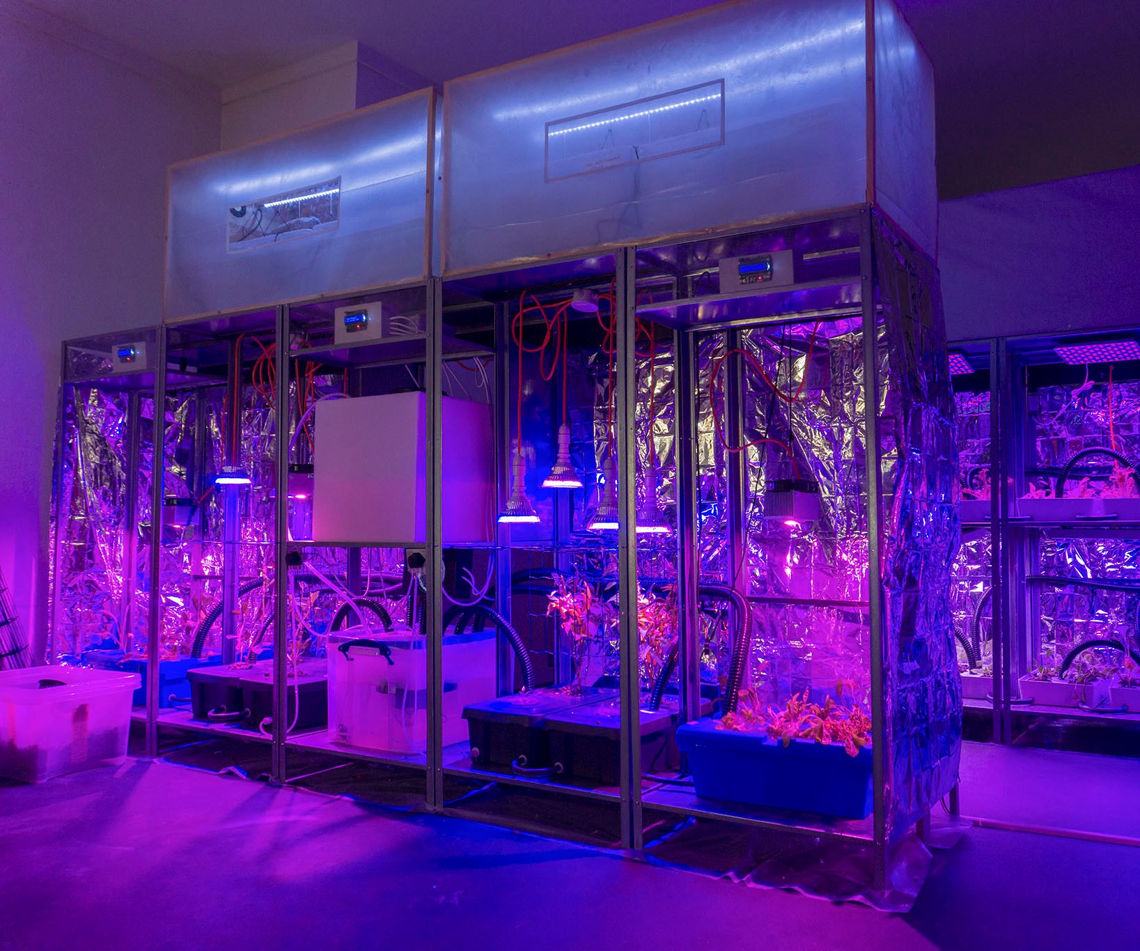

Step 1: Building the Stack
Material list:
- 1l bottle of freshwater
- Tubing system
- Led lights or warm lights
- French press
- Spirulina Plantesis culture
- Nutrients (Bicarbonate Sodium + Phosphorus)
- Timer
- "T" connectors
- Air Pump
Steps:
- Build the frame of the algae stack - Here we chose an IKEA shelf to simplify the structure of the system.
- Choose and place the number of medium you need to put in the stack
- Install the air pump in the stack and link it to the bottles via PVC tubes - If you want multiple media you will need to divide the tube to provide air to all the bottles.
- Put the light system next to the bottles of Spirulina to provide warmth and light to encourage the photosynthesis reaction.
