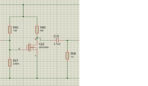

1. Gain Stage: The gain stage uses a potential divider biased mosfet amplifier circuit. The potential divider biased circuit is shown in figure 1.
It simply amplifies the input signal and produces gain according to the equation (1).
Gain = [ ( R1 || R2)/ (rs+ R1 || R2 ) ] * (-gm) * ( rd || RD || RL) (1)
Here, R1 and R2 are the input resistances, rs is the source resistance, RD is the resistance between bias voltage and drain and RL is the load resistance.
gm is transconductance which is defined as the ratio of the change in drain current to the change in gate voltage.
It is given as
gm = Delta (ID) / delta (VGS) (2)
To produce the desired gain three potential divider biased circuits were cascaded in series and the total gain is the product of the gains of individual stages.
Total Gain = A1*A2*A3 (3)
Where, A1, A2 and A3 are the gains of first, second and third stage respectively.
The stages are isolated from each other with the help of interconnected capacitors that is RC coupling.

> R1, R5, R9 = 1MΩ
> R2, R6, R11 = 68Ω
> R3, R7, R10 = 230KΩ
> R4, R8, R12 = 1KΩ
> R13, R14 = 10KΩ
> C1, C2, C3, C4, C5 = 4.7µF
> C6, C7 = 1.5µF
> Q1, Q2, Q3 = 2N7000
> Q4 = TIP122
> Q5 = TIP127
The circuit simply consists three gain stages connected in cascade.

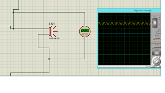

Gain stages are connected through RC coupling. RC coupling is the most widely used method of coupling in multistage amplifiers. In this case the Resistance R is the resistor connected at the source terminal and the capacitor C is connected between the amplifiers. It is also called a blocking capacitor, since it will block DC voltage. The input after passing through these stages reach the power stage. The power stage uses BJT transistors (one npn and one pnp). Loudspeaker is connected at the output of this stage and we get an amplified audio signal. Signal given to the circuit for simulation is 10mV sin wave and the output at the loudspeaker is 2.72 V sin wave.

Figure.10 Output of three gain stages (Total Gain = 308)
Figure.11 Output at the loudspeaker
