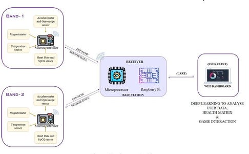

🔌 Connections & Circuit Diagram
All sensors are connected to the XIAO via I2C:
Step 2: How Data Transfers Between XIAO and ESP32
How MotionSpike Works
Imagine turning your body into a game controller — now imagine doing that with a friend. That’s exactly what MotionSpike is all about!
Dual-Player Motion & Health Tracking
MotionSpike is an interactive system that combines wearable tech and wireless data streaming to transform physical movements into digital inputs. Whether it’s a jump in Dino Run or a perfect push-up rep, your body becomes the controller!
System Overview
We use:
  1. 2 x Seeed Studio XIAO microcontrollers (one per player)
  2. 1 x ESP32 (acts as the central master)
  3. Sensors per XIAO:
  4. MPU6050 – For motion and orientation
  5. MAX30102 – For heart rate and oxygen level
  6. Magnetometer – For directional heading
Each player wears a band powered by the XIAO board, capturing motion and biometric data in real-time. This data is then wirelessly sent to the ESP32, which acts as the Wi-Fi Access Point and data receiver.
Communication Flow
Each XIAO device:
  1. Connects to the ESP32 using UDP over Wi-Fi.
  2. Sends formatted sensor data packets continuously.
The ESP32:
  1. Hosts the Wi-Fi network (SSID: Master, Password: 12345678).
  2. Listens for UDP packets on port 12345.
  3. Parses data and displays it on the Serial Monitor.
  4. Optionally forwards data to a connected Python application for gesture recognition and game control.
Software Flow
  1. xiao_player0.ino and xiao_player1.ino: Handle sensor reading and UDP transmission for Player 1 and Player 2.
  2. esp32_master.ino: Receives, parses, and outputs all incoming data.
  3. A Python game control script (on the laptop) interprets this data to trigger actions like jumps, squats, and punches.
