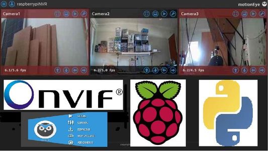

motionEye capture video streams via RTSP (Real Time Streaming Protocol) or HTTP. RTSP is a pure streaming protocol and pan/tilt commands can not be send to the camera via RTSP. You may or may not be able to find the HTTP commands for your specific camera's pan / tilt commands in your cameras documentation. To avoid this complexities, it is easier to send ONVIF commands to an ONVIF compliant camera
Since the basics of motionEye is covered at the above mentioned web pages, I will not go through it again, but I will focus on how to control ONVIF compliant cameras pan and tilt function via motionEye. ONVIF is an open industry forum that provides and promotes standardized interfaces for effective interoperability of IP-based physical security products.

Restart motioneye with
systemctl restart motioneye
You should now see the action buttons on the motionEye web interface and they should be able to pan and tilt your ONVIF compliant cameras.
