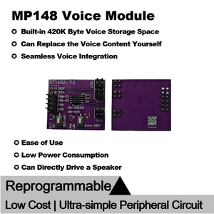

What is the MP148?
A ready-to-use module built around the KT148A 32-bit DSP voice chip (SOP8 package).
Key features:
🔹 420KB storage (up to 400s audio at 8KHz).
🔹 Direct 0.5W speaker drive (no amplifier needed).
🔹 Serial reprogramming via USB-to-TTL (no expensive tools).
🔹 Ultra-low power: 25µA standby, 1.7µA shutdown.
Perfect for:
🔹 Smart toys, industrial alarms, accessibility devices, and IoT voice prompts.

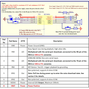

2. Hardware Setup
Wiring Diagram:
MP148 Pinout:
- VBAT (Pin 8) → 5V
- GND (Pin 1) → Ground
- PB9 (Pin 2) → CH340G RX
- PB1 (Pin 3) → CH340G TX
- SPK1/SPK2 → Speaker

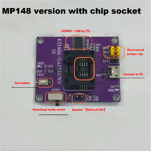

Step 2: Enter Download Mode
  1. Hold Pin 5 (SPK1) to ground while powering on. Release after "beep."
Step 3: Upload via Serial Tool
  1. Connect CH340G to MP148 (TX/RX crossed).
  2. Open VoiceCom_V8.exe, select COM port (115200 baud).
  3. Load .F1A files → Click "Download All."
