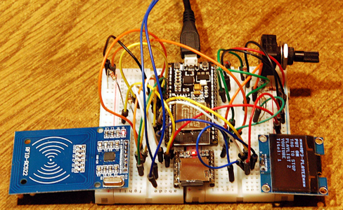

It's been a while that I have one Christmas raffle with RFID tags programmed for the ESP32. The contribution with the Speech output of measurement results back. I recorded the scraps of language with my cell phone and transferred to an SD card. Now you could of course also save music pieces on the SD card and call up via RFID tags-an MP3 player with expansion potential is ready. I tried various approaches for programming. What initially looked promising and interesting, an approach with threading, finally had to be abandoned in favor of conventional programming By grinding because the performance did not meet my ideas. I am now introducing this solution to you with the new post from the series.
Strictly speaking, I came up with the idea of ​​this post through the articles on the subject of serial interfaces on ESP32/ESP8266 dem Raspberry Pi Pico and that PC. I wanted to show some other applications on the RS232 ports. Well, the DFPlayer Mini, which is used here, is controlled via the serial interface. And because a bidirectional data exchange is used, only one ESP32 or a Raspberry Pi Pico as a controller. A PC would also be able to parlice directly with a DFPlayer Mini via an RS232 TTL converter, but I leave that out. We have already arrived at the hardware list.
The assembly on two mini-breakboards looks through the many jumper cables bird game. After all, four interfaces are used, SPI (RFID reader), I2C (OLED display), RS232 (DFPlayer Mini) and ADC (Poti).

illustration 1: MP3 player - structure with SH1106
There are a few things to consider. The DFPlayer Mini must be supplied with 5V. Therefore, impulses with a level of 5V are also on his PIN TX, as is the busy pin. Because the ESP32 can only tolerate 3.3V to its GPIOs, the levels must be reduced By voltage divisors. I chose 1kΩ and 2.2kΩ. You can also take other values ​​that are in a ratio of 1: 2. Conversely, the DFPlayer at the RX input copes well with the 3.3V signals from the ESP32.
If the speakers are placed on GND with the black line, the 5V circle flows into electricity of approx. 450mA! This is because the connections SP1 and SP2 lead 5V level. Therefore, only connect the two speakers to SP1 and SP2, not to GND. Even if you only use one speaker, its lines belong on SP1 and SP2 (in Figure 2 yellow). Otherwise you would have to connect the speakers via an ELKO.
illustration 2: DFPlayer Mini with 4 GB SD card
The ADC input on the ESP32 can process tensions up to 2.4V. However, the potentiometer is 3.3V. Therefore, I reduce the offset voltage By counting a resistance of 2.2kΩ. So that the potentiometer can be put on the Breadboard, I have provided the connections with a 5-pin pen strip.
illustration 3: Poti with pen strip for the Bread Board Montage
You have to be particularly careful with the displays mentioned. The connections for SDA and SCK agree, but the pins for +VCC and GND with the 96 "module (pen strip above) are exchanged against each other in the 1.3" module (pen bar below). I used a 1.3 "module in the circuit of Figure 4.
illustration 4: SH1106 in operation
illustration 5: MP3 player - circuit
For autonomous operation, I have provided a battery owner for a Li-ion battery of the 16850. It can be connected directly to the ESP32 with the enclosed cable, which then takes over the supply of the other modules.
illustration 6: Battery owner 18650
The connection plan may be helpful for placing the circuit together.
illustration 7: Connecting plan
An ESP32 takes over the chief position. For its use, two Breadboards are required, which are connected to a power rail in the middle, so that you can get there with the intervals of the pin rows and cable can also be inserted on the edge.
The little brother of the ESP32, the ESP8266, is unsuitable for our purpose, because it cannot offer a second, full uart interface, and we need it to control the DFPlayer.
