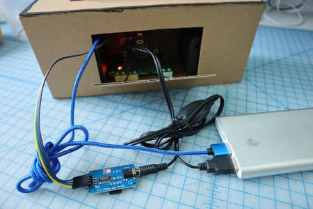

Step 9: Connect the MP3 Player Circuit
- Connect the MP3 Player Circuit.
- RX = Pin P0
- TX = Pin P1
- VCC = +
- GND = -

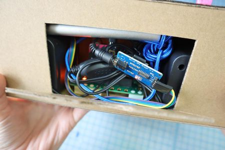

Step 14: Stuff Everything Inside!
- Plug in the two USB cables (one connected to the micro:bit and the other connected to the speakers) into a USB battery pack to make the project portable.
- Stuff everything inside the box. If your speakers have a volume adjustment, set it to full volume before closing the door.
