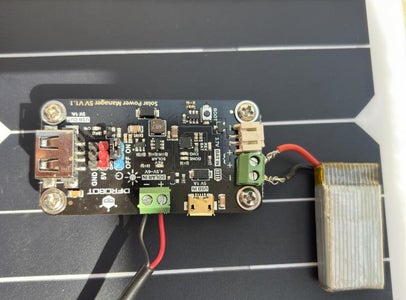

Solar Power Manager 5V is a small power and high-efficiency solar power management module designed for 5V solar panels. It features as MPPT (Maximum Power Point Tracking) function, maximizing the efficiency of the solar panel. The module can provide up to 900mA charging current to 3.7V Li battery with USB charger or solar panel. The ON/OFF controllable DC-DC converters with 5V 1A output satisfies the needs of various solar power projects and low-power applications.

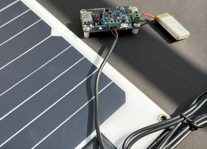

Step 6: Starting the Solar Powered System:
  1. Connect the Li battery to BAT IN.
  2. Connect the solar panel to SOLAR IN.
  3. Insert the jumper on the ON of the blue header to enable battery.
Note: After inserting the battery jumper in the correct position, the module USB OUT/5V pin header (red) does not output any voltage immediately due to the protection function. To enable this function, either turn on battery charging or press the onboard boot button which can be seen in section one of the schema.

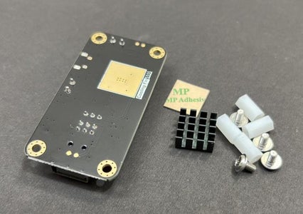

Step 7: Cooling Fin Add-On:
If a 5W (or above) solar panel or USB charger is used, the CN3165 may run in full load, trying to charge the battery at maximum 900mA.
The chip has an over-temperature protection function, which will automatically limit the charge current, trying to protect the chip. To improve cooling and maximize charge current, which results in longer life-span and better performance, it is highly recommended to stick the Aluminum cooling fin with the blue thermal conductive silica pad to the bottom of the module.

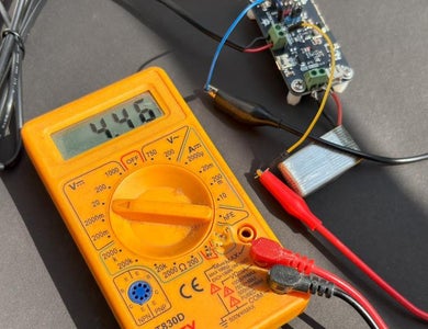

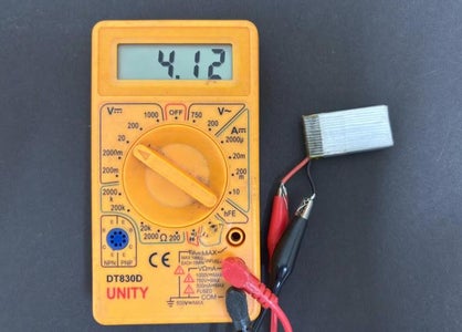

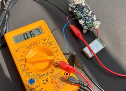

Step 13: Final Testing:
Current Ratings from Solar: Image 1
Voltage from Solar: Image 2
