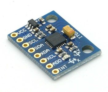

Step 1: WHAT IS MPU6050?
The MPU-6050 an IMU (Inertial Measurement Unit) sensor that helps us to measure motion and orientation of the object in which it is mounted. This 2cmx1.6cm board contains 3 axis accelerometer and 3 axis gyroscope. This also have DMP (Digital motion processor) which help us to perform complex calculation onboard rather than relying on microcontroller.
