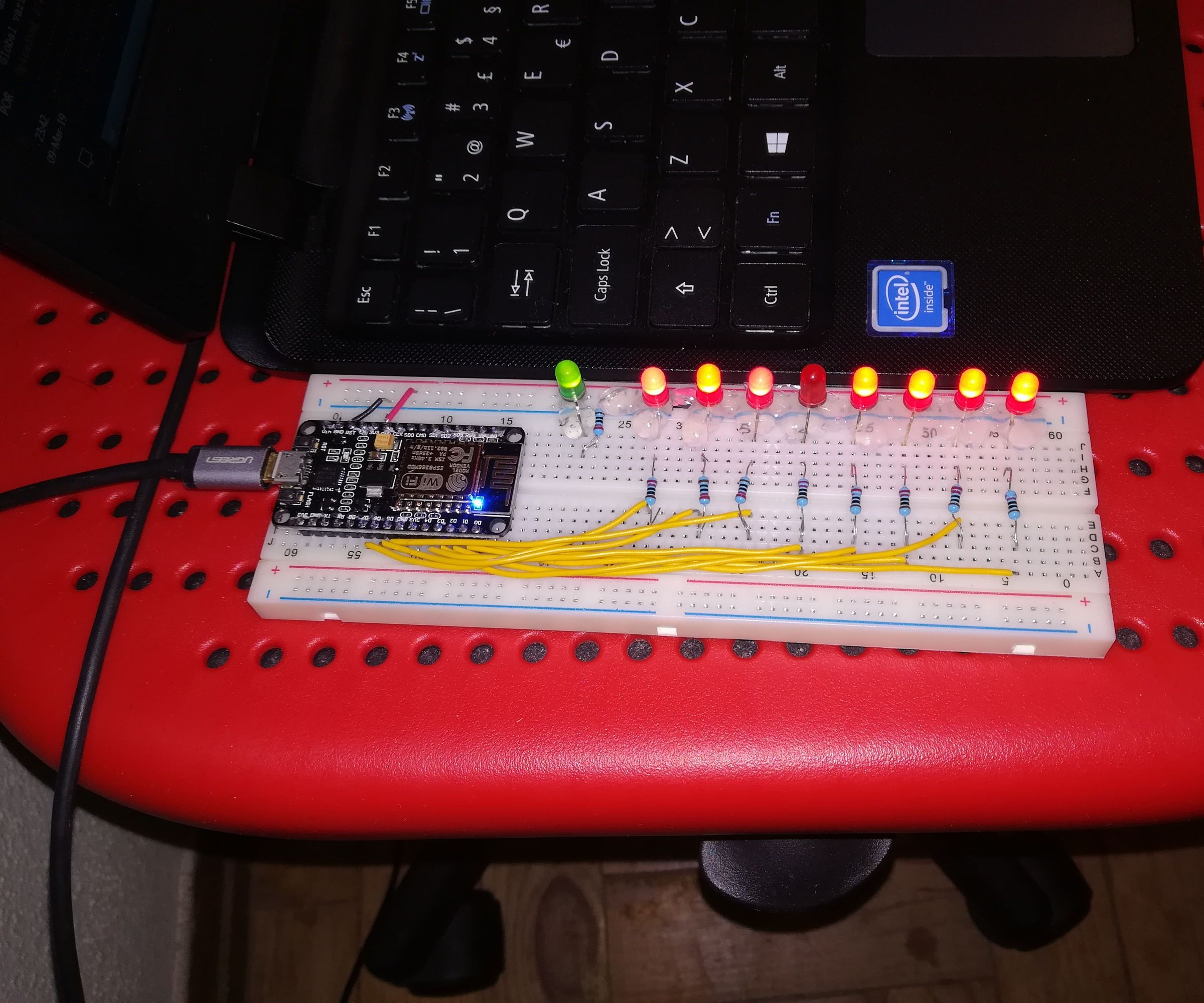

Introduction: MQTT Bare Minimum Sketch for ESP8266
If you are new to MQTT and you want a simple example to start with, this is for you. This example uses CloudMQTT to run a very simple sketch in a ESP8266 ESP-01 module that publishes and subscribes a led status that you may use for your more complex projects. Simple put it, is a Bare Minimum for your own sketches!
